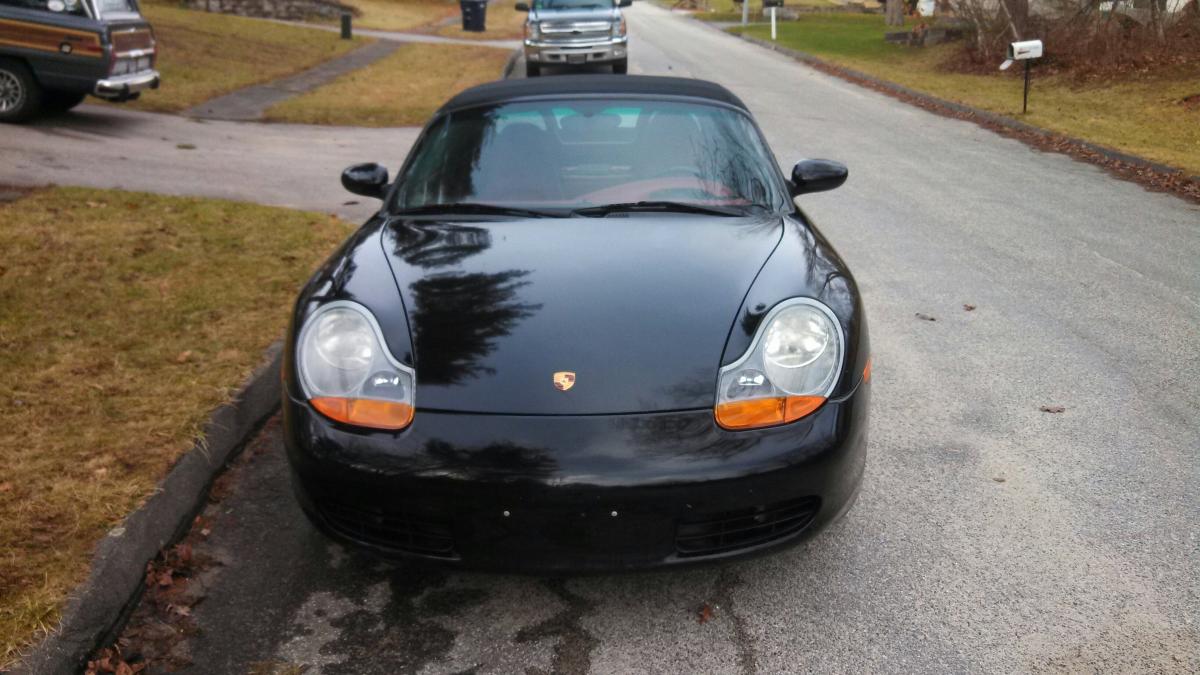

Hi All,
Wanted to check and see if anyone else has had this issue. When I lock the car with the key by placing it in the drivers door and turning it to the right the car seems like its about to lock but then beeps twice and the intrior light comes on for a short period of time. I then check the door and the drivers side door is locked however the passenger side is not. The key fob is not working either and hasn't since i've owned the car (approx. 1 month) which seems like a common issue from the posts i've read. It will not lock/open or pop the trunk. Possibly needs reprogramming from what i've read but it seems like I should still be able to manually lock the car. Any help would be appreciated.
