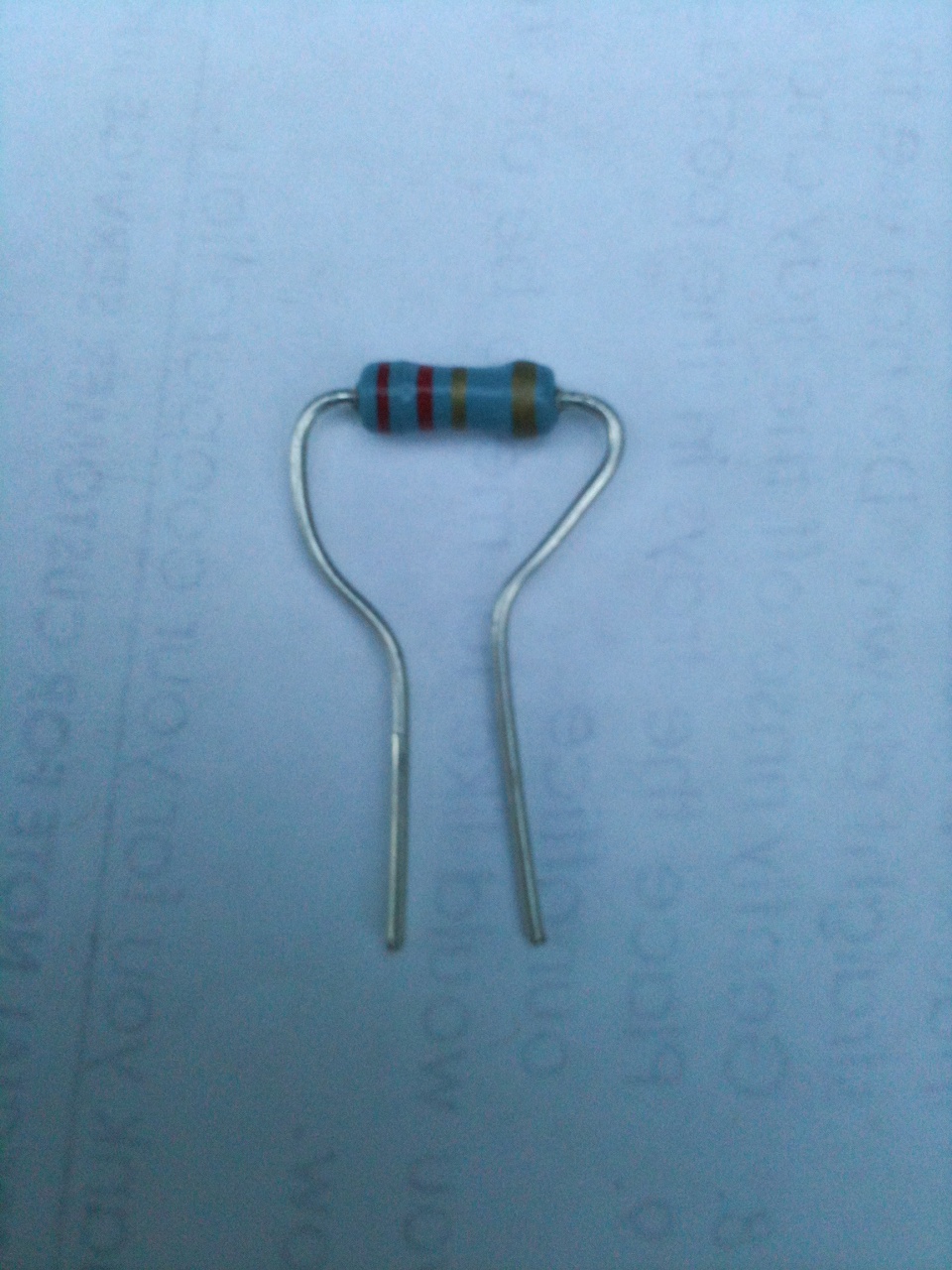

Loren knows Porsche cars better than anyone here. As he said start with cleaning the seat belt buckle contacts and connectors with good quality electronic contact cleaner. Also check your grounds. Then clear the codes. If the system dose not throw any codes your good to go. If you do throw any codes the female side buckle would be the next suspect. If you want to prove it you can make yourself a simulator with 2.5 ohm resister see picture. Unplug the belt buckle connecter and jump the pins on the harness side. This will simulate a good know buckle. Now try to clear the codes with your Durametric. If that works you have proven the passengers side belt buckle is the fault.

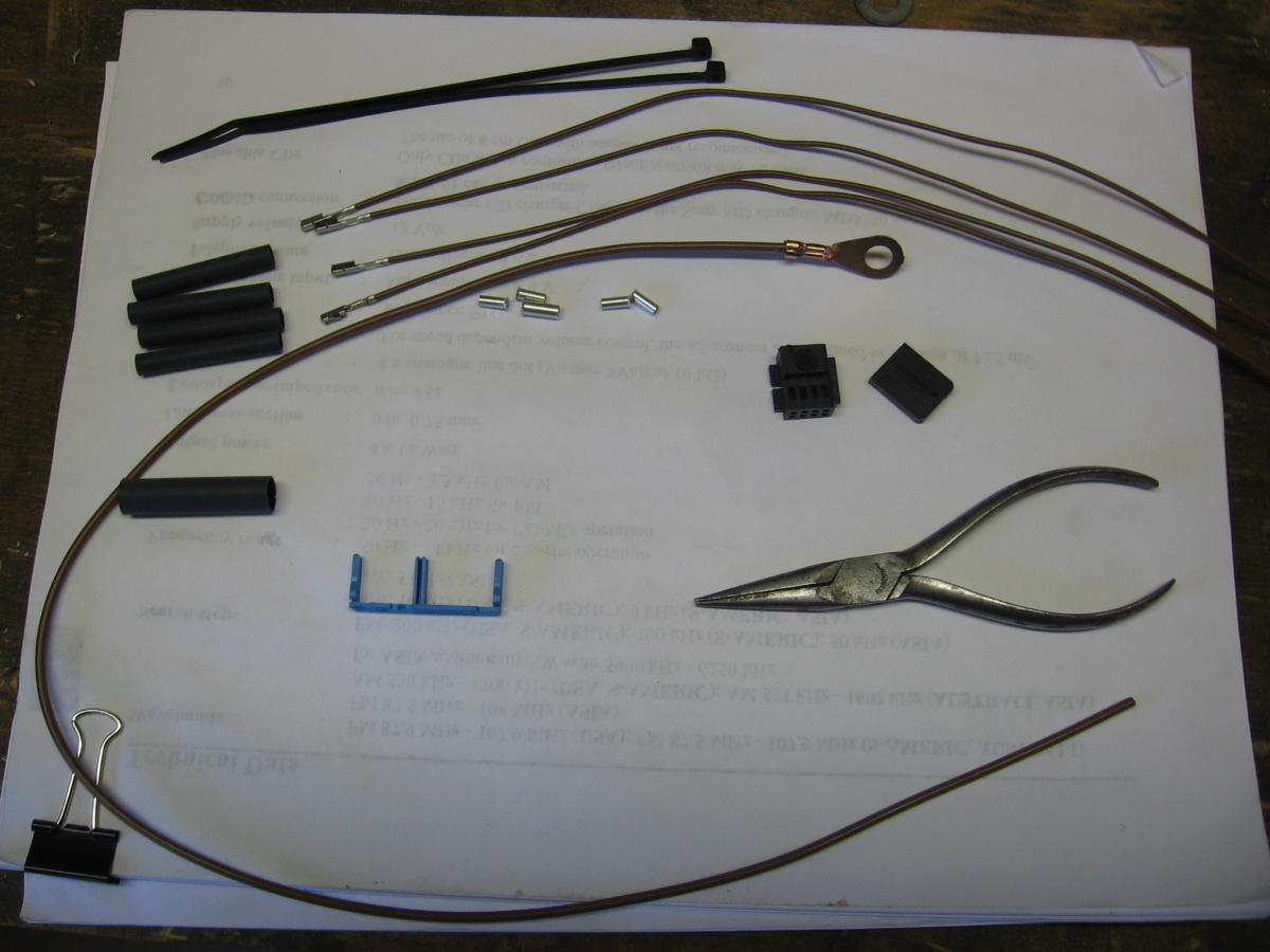

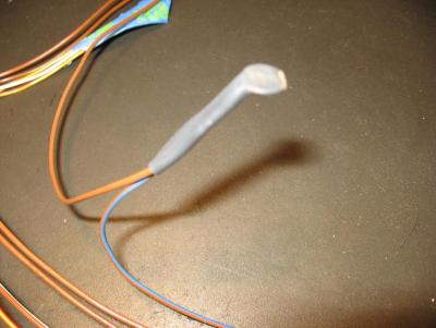

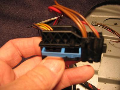

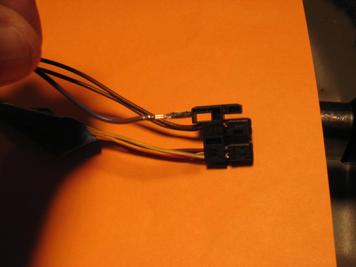

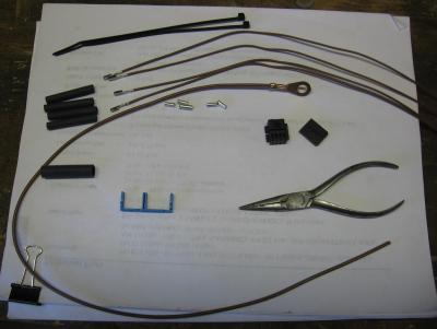

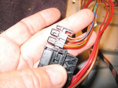

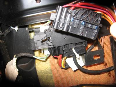

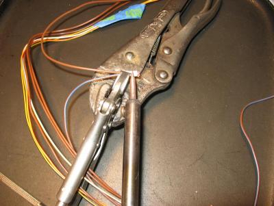

I just completed this project and the my dash light has been extinguished. I've attached a few pictures which I hope might help anyone thinking about doing it. Apparently, the "Kit" is a "general use package" and has enough pieces to do 4 terminals and the grounds, and some plastic that did not fit anywhere on my 02-C2-996, but probably fits other models. Actually, the entire plug-body (not shown in picture) was also in the kit, but like many of the other pieces, I did not use it. The terminals in question were easily located referencing the general wiring diagram (color coded Brown & Brown/Blue) and they were actually numbered directly on the black plastic terminal holder, as long as your eye sight is good enough to see them. To my naked eye, nothing appeared to be wrong with any of the terminals, or the wiring. I did discover two (unrelated) wires under my seat which had the insulation torn and needed taping. I have no idea what these wires do, definitely not part of this procedure, but nevertheless simply repaired them with electrical tape. Since I was already in there for a visual, I decided to follow the TSB, replace the terminals, and splice the wires accordingly. I did not need a special tool to release the terminals from there plastic plug-holder. I merely pushed down on the very tiny triangular shaped "pin holder" (visible through a notch in the plug) with a tiny metal needle, gently pulled the terminal out, and slid the new one directly in. I completed the splicing and soldering as instructed. I then replaced the passenger seat belt buckle with a new one, re-leading the seatbelt wires through various clamps under the seat exactly as they were originally fit and replacing the green plug. The seat belt buckle replacement was a very straight-forward, simple job, and I can't help wondering if replacing the buckle was all I really needed to do? Aside from everything being extremely tiny and light-weight, I did not consider this overall job (TSB instructions) to be too difficult. After re-assembly, and having to use my emergency front trunk pull to re-open the hood which I (very foolishly) closed over the thoroughly disconnected battery, I used my Durametric to clear the fault code. I apparently do not fully understand the Durametric procedures because it took me several attempts, and a short drive with the dash light still on, followed by another few retries, till I was finally able to clear the code and extinguish the dash light. For a while, I thought the procedure was a failure, but I'm also wondering if it takes a little extra time after reconnecting the battery for the airbag system to fully arm itself? Thanks to everyone for their help.
