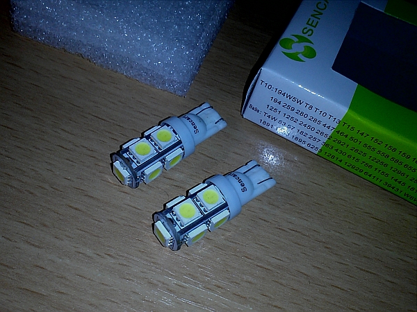

Finally received the 5 LEDs/bulb I orderd about two months ago... free shipping... took six weeks to receive them. Earlier on this post I summarized the 9 LEDs/bulb bulbs I first received. I finally made some free time to summarize these findings:

B. 9 LED/bulb bulb: Current = 0.09 Amps, temperature 45.3C (113F), "brightness" F11.3

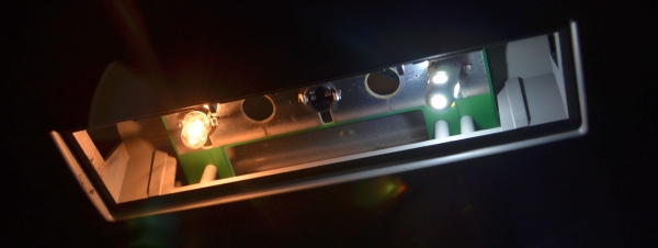

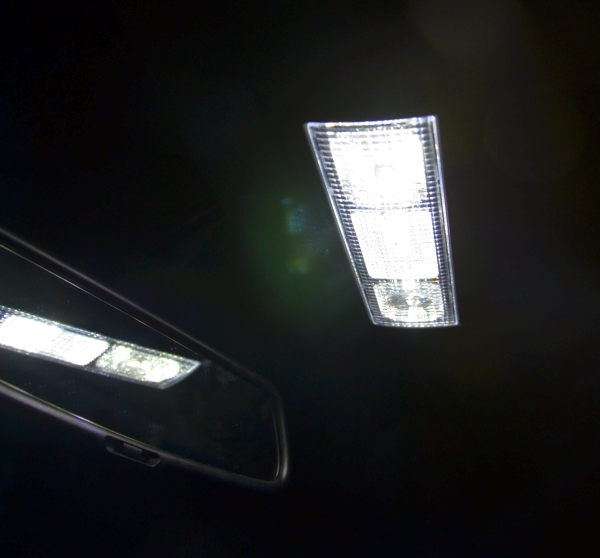

Here are some Pics:
post-88071-0-74633100-1369629709_thumb.j
Incandescent (IC) and LED together
post-88071-0-68148600-1369629713_thumb.j
Bare bulbs with no reflector/lens fixture
post-88071-0-91896100-1369629718_thumb.j
One IC bulb and two LED bulbs

post-88071-0-65246200-1369629741_thumb.j
All three IC bulbs replaced with LED bulbs

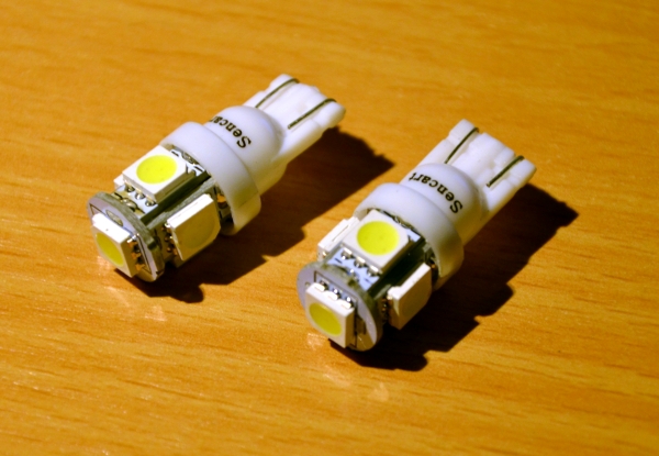

post-88071-0-54906600-1369629747_thumb.j
The 5 LED/bulb bulbs
