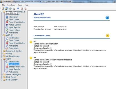

Durametric shows 2 fault codes on the Alarm system but states "This fault is displayed for informational purposes, it is not an idication of a problem and no repair is needed"
attachment=28096:boxster-AlarmFaultCodes.jpg]
The double beep indicated there really is a problem. Do the faults listed give a clue where the issue is?

In either case a PST2 or PIWIS will pinpoint the problem(s).
It is the microswitch in the door lock which senses that the door lock has reached the unlock position which is causing the problem. (Unlock not reached). The door is unlocked, but the system hasn't received the signal - hence the double-beep.
It doesn't say which door, but you might be able to determine which by looking at the input signals. See if you can see the "locked" switch on each door when you lock and unlock them.
It is the microswitch in the door lock which senses that the door lock has reached the unlock position which is causing the problem. (Unlock not reached). The door is unlocked, but the system hasn't received the signal - hence the double-beep.It doesn't say which door, but you might be able to determine which by looking at the input signals. See if you can see the "locked" switch on each door when you lock and unlock them.
