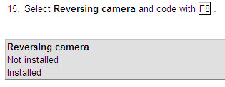

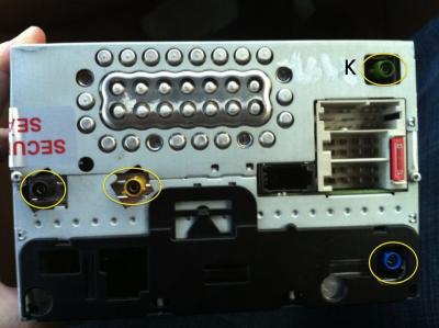

In PCM2.1 there is a coding option for "with Reversing Camera" which can be set by using a PIWIS tester. On the back of the PCM unit there is a Fakra connector for the camera input. IIRC it is at the top right hand side as you look at the back of the unit. I have a photo somewhere, and will post it later when I get to my PC.
This is the back of the PCM (photo courtesy of someone else here) and I have marked what I believe to be connector K, which is the video input:
post-4000-0-24778500-1366301606_thumb.jp
And this is from the manual which shows coding for Reversing Camera:

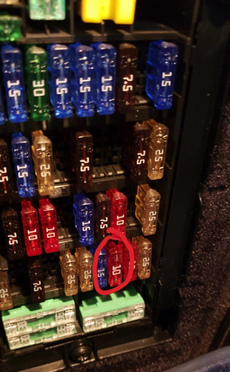

Guys... I have search everywhere and couldn't seem to find anyone that has done this cleanly.
But this month I was successful in adding a backup camera to my 2007 997 C2 Cab using this following parts!
My goal was to maintain my current PCM 2.1b system, just add reverse camera. (I don't want to add a 3rd party NAV/Audio system. I quite like my BOSE)
TVandNav2Go . (This system can push video signal to my factory PCM 2.1b screen when reverse is selected)
http://tvandnav2go.com/porsche/43-po...interface.html
Camera (Fits cleanly in the reverse light receptacle.
https://www.aliexpress.com/item/Car-...001132931.html
Many thanks,
RP
