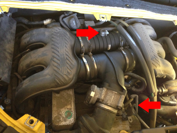

Got into the engine compartment today just to look around and found a bracket with nothing connected as well as a hole plugged where it looks like a hose might have gone.
Can you guys look at the picture attached and let me know what you know?

The bottom arrow in your photo is pointing to the lift point used at the factory for moving the engine/trans around. Nothing to worry about.
The top arrow appears to be pointing to the location of the butterfly which balances intake air pressures. Under the tube is a vacuum control that actuates the butterly. What you think is a plug is likley the cover over the butterfly's shaft. Probably nothing to worry about there, either.
