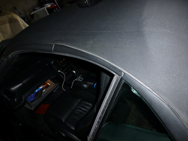

Hiya. Hope I can get a little help. Recently picked up my new 996 - loving it, but the indicators don't seem to self cancel after a turning a corner - is this a major issue? Also when the roof goes up it does exactly the same as my Boxster did at times. The beading around the edge of the hood does not sit in the channel (pic below). Is there a quick fix for this? Thanks in appreciation of your help... Martin

The top has a thin wire cable that guides the edge into the channel. Most likely one end has come loose.
