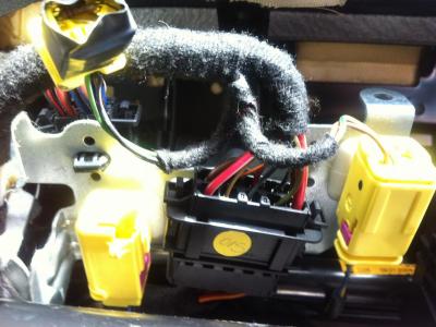

by the way........... first time i pay attention to all the wires and connections under the seat.
there are 2 yellow clips. just one is connected , the other one is closed with a tape.
anyone a clue for what these connections are?
tom
Yellow connectors are mainly used on airbag systems, check with a PIWIS whether the system is still intact and working, seems to be a abnormal situation if you ask me.
I'm always serious, never mess with yellow connectors and their wirings. Follow the wiring and look where they arrive, that would be a good start, or use a diagram, this is even better.
Jesus. What to expect from a porsche service guy if he didnt notice this. They changed battery 2 times and they never had a look at this wires. Scares me.
Do you know from where to get a diagramm to check these wires?
