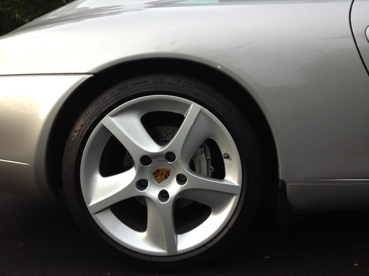

I have read the TSB, which indicates that the rear fenders may need to be rolled, but I haven't seen any posts that indicated that rolling was actually necessary. So I am hoping to get some practical advice from anyone who has installed the Sport Technos on an MK1 996 with 295/30x18 tires in the rear. Any feedback would be appreciated. Thanks.
Lots of views, but no feedback; so I am updating myself. Acquired the Sport Technos with Michelins Pilot Sports. So far so good. Mounted with what appears to be sufficient clearance in the rear. I'll post more info following some road testing.
