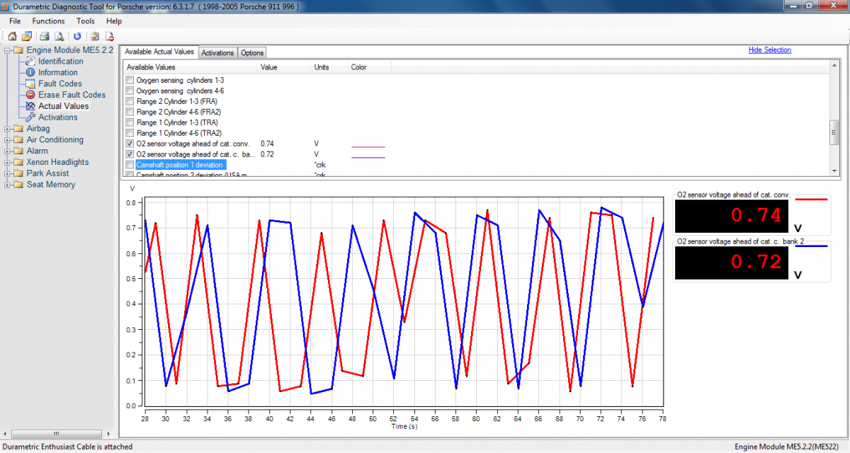

The O2 sensor readings were for both pre- and post-catalytic converter. Attached is a screenshot of the O2 sensor readings from Durametric when warm. The low values seem to be lower today than yesterday. Getting cold numbers is a bit more difficult due to working in the morning, but I will try to provide those when I can.
Unless you mean "Oxygen sensing cylinders 1-3" and "Oxygen sensing cylinders 4-6", I am not seeing how to measure the O2 sensor voltage of a specific bank. And the oxygen sensing reading for cylinders 1-3 is 1.01 to 1.05 and for cylinders 4-6 s 0.99 to 1.02, which seems out of the sweet spot if that value does reflect an O2 sensor - unless maybe the value is scaled so that 1.0 is 14.7:1...?

The screenshot gives us one more piece of the puzzle. The upstream o2 sensors should be switching 200 mV to 850 mV. for a 14.7:1 fuel ratio. Your o2 sensors 0.4 mV to 0.74mV is giving a lean bis command to the ECU in turn adds more fuel. Do you know if you were in closed loop when you took the screen shot? the cat needs to be at least 600 F. to go in to closed loop. You really need more than just a fuel presser gauge and a vacuum pump and gauge to get to the root cause of the issue. You should also have scan tool that can show what the long term and short fuel trims are doing for a proper diagnosis.

Your attached O2 readings seems to be for bank 1 (red) and bank 2(blue) both pre-cat sensors. They look fine (good voltage range) albeit switching a little slower than I remember. Would be good to also log the same during cold start. Should take a couple of minutes if that to get smiilar swinging measurements since the O2 sensors are heated.
I know it can be confusing how these systems work. It is the opposite of what we might think. The o2 sensor reads the gas just before the cat and sends a signal to the DME. If it has low voltage the DME sees that as the motor is too lean. The DME now commands the injectors to add more fuel by making pulse width longer. That's why your car is running rich. Hope this helps.

Now I see what the problem is. Jason said he saw 0.4V-0.78V but your post said 0.4mV to 0.78mV....the units are different.
The coolant was warm when I took the screen shot as I had just driven home. However, the car was off for a few minutes prior to the reading in order to grab my laptop and Durametric, so if there is some sort of temperature gauge on or near the catalytic converter, then I have no idea what the temperature was at the time of the reading. It is almost the weekend, so I will try to read up more on the Durametric and provide more information then.

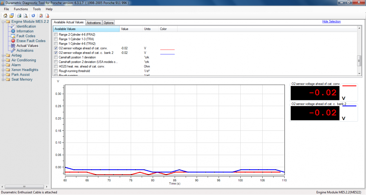

That might be due to the Durametric has a time value in which it polls for updates, and I left it at the default value. I will try to read up more on it this weekend and hopefully provide additional information.

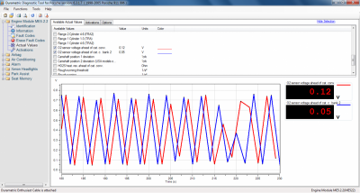

Attached are the cold reading values. As you said, at first nearly no voltage was read, but after about a minute, the values started oscillating.
For clarification, I did see 0.4V-0.78V the first time (without a screenshot) and 0.05V to 0.75V the second time. See the screenshot in my previous post for the graph the Durametric tool generated.

Your "O2 2k" graph is very strange that the sensors are swinging way too slowly. Was the reading taken at idle or other rpm? Also, what was the sampling rate? At idle, I expect swinging about once per second and at 2k rpm, the swinging should be even faster.
The original readings were done either at idle or 2,500 RPM. Those did not have the refresh rate in Durametric maxed out. The readings in the zip file were done at 2,000 RPM with the Durametric refresh rate set to the max.
