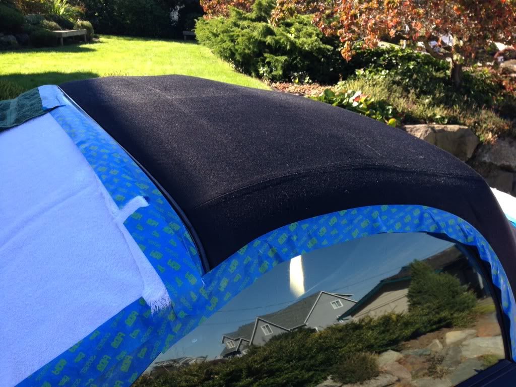

Usually the cleaner will last several treatments. You can also buy a kit that comes with a soft brush for cleaning.
Using short circular strokes to clean the cabriolet well. Then rinse it well.
I let it dry thoroughly in the sun, then mask it off and use a whole can of the protectant.
During a recent rain (hard to believe I know , rain in Seattle!) The protectant works great!
Edited by kbrandsma
