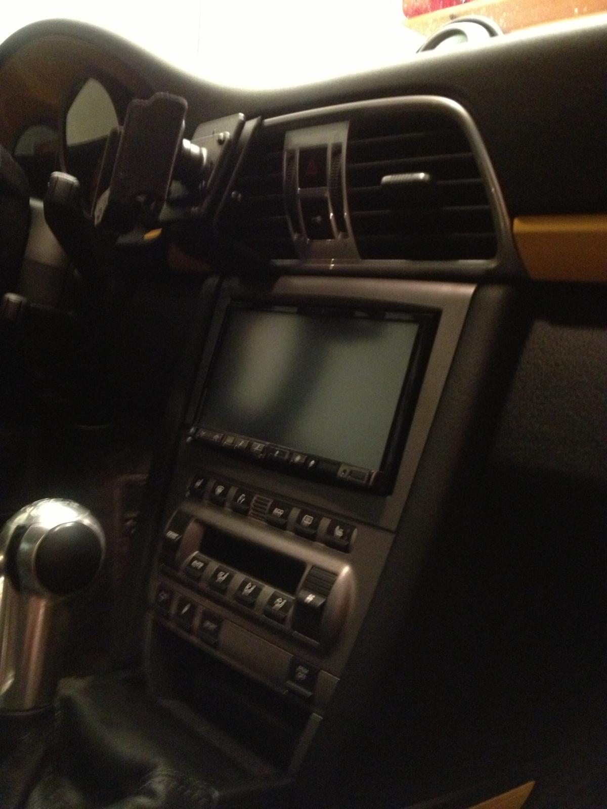

Jam996 there was another thread in which the owner complained of a similar issue. It turned out that the cable to the DVD drive in the trunk was loose. Personally, PCM of any version is trash. You can now replace it with an aftermarket head unit, a MOST head unit replacement module and keep all your amps and speakers stock. You can get the Best NAV with either Kenwood or Alpine, perfect iPod integration and Bluetooth and much better sound!post-89070-0-78946000-1375643788_thumb.j This one is an Alpine INE-W927HD
