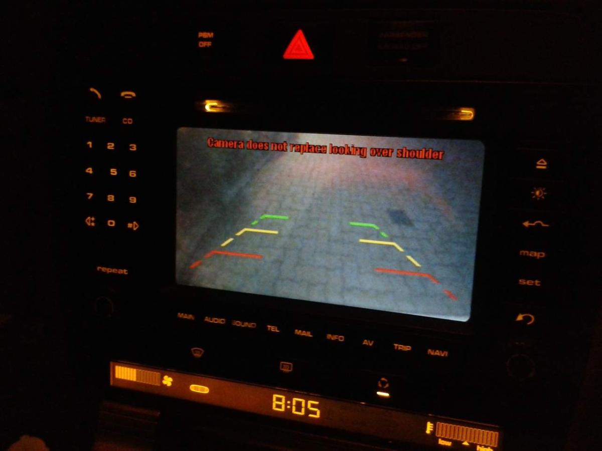

I did see that DIY.  All it shows is how to take off the panel/panels to either side of the camera section, then shows a pic with the camera gone.  I hope it's self explanatory after I get the panels off.  Believe all I need to do is re-attach the cable, as the camera works when I manipulate the cable.
Thanks
Pop off the panel. Becareful doing it but work along the edge and it's fairly easy to get off and on. When I replaced my camera (with an aftermarket Ebay item)  I had it off & on a few times. You may just find a little contact cleaner on the Fakra connector is all you need. The smaller square connector is for the video and the larger 2 or 3 wire connector is for the power to extend/retract. Does yours always extend/retract? If so then the camera portion is all you need to work with. Porsche only replaces the whole assembly for something like $1500 and you still get 10yr old tech. You can get 10yr old tech on Ebay for $20 but will need a RCA to Fakra connector and it looks as good as OEM or possibly even better.

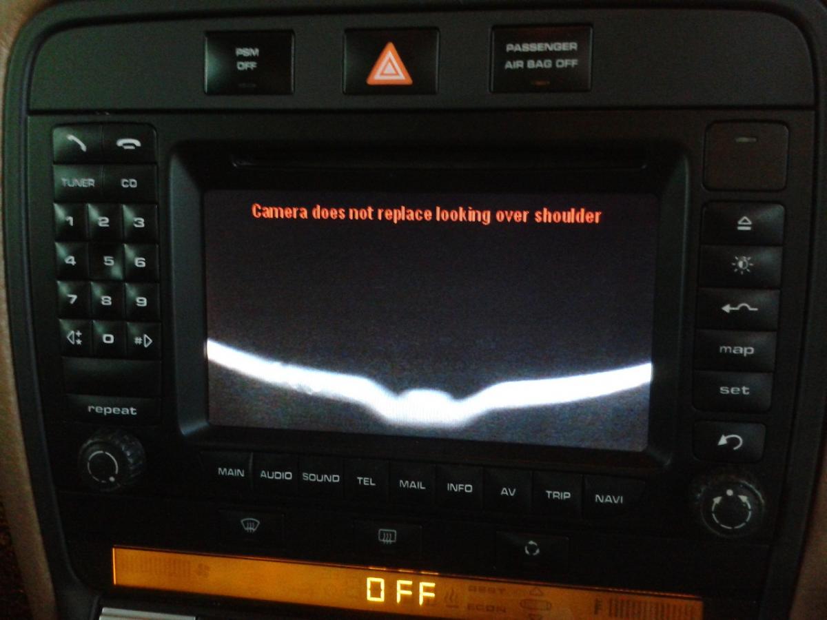

Hi there,
my reverse camera does not flip out on my 2007 Cayenne 3.6. i see only a horizontal curve line in the screen.
Loren, can you send me the tips to remove the rear camera as well ?
many thanx !
i have the same issue and do not want to spend $1500 on a new one. Local Euro shop has tried twice say motor is hot jamming up. Need a replacement or workaround. Help! THanks
