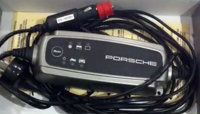

now I have a portable jumpstart power pack. I am purchasing the Porsche battery maintainer from UK
I plan to charge the battery like this :
Jumpstart power pack (13.3V) --> 12V-220V-DC-AC-inverter --> Porsche battery maintainer---> Cayenne S(12V socket)
do you think this would work?

Over the last few days, what I did was that I charged the battery by connecting to the jumpstart terminals with a jumpstart power pack.
it did charge the battery! The voltage (in armed state) went from 11.6V to 12.2V.
However, the "Start Engine" still appears before the engine is started. so I guess the battery is still not fully charged.
The next experiment I will do is :
jumpstart power pack--> 12V-DC-220V0AC inverter-->Porsche battery maintainer-->Cayenne S 2003
I am awaiting the Porsche battery maintainer shipment from UK.
