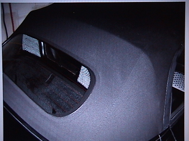

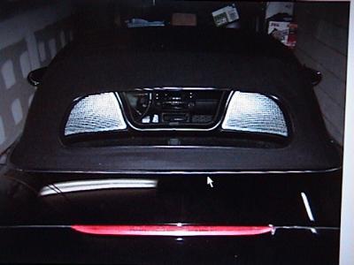

Tried to take pics of the horizontal orange elements on the oem window.
Edited: The top pic is a 987 and the bottom is a 2003 986.

...Tried to take pics of the horizontal orange elements on the oem window.
I assume the photos you took were off the 987? The rear glass looks a lot larger than the ones pictured on cabrioworld.com....

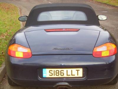

Here are some pics. The lighting was not the greatest, and these are actually pictures of the originalpitures I took. Evidentely I had the resolution set too high when I took them because when I went to upload them to this message it said the file size was too big. So I pulled them up on my computer screen and took lower quality shots. I will try to get some better shots that I can actually post sometime soon.

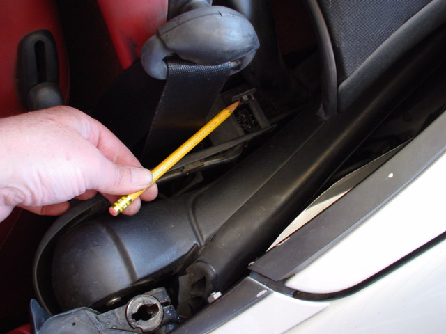

You should have the plug already wired for the defroster since it comes with heated mirrors and that is standard in the US.
Steve at BAS asked me how GAHH did their electrical connector for the window but I could not tell him since I have never seen the GAHH top in person.
Still would like to see the GAHH top in the service position.
