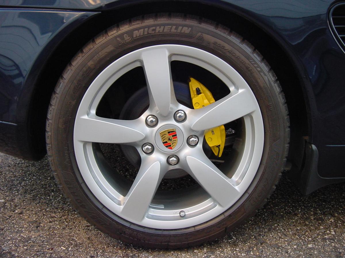

TiKore Industries makes fabulous Ti lug bolts in both single and two piece designs. The two piece are much more expensive. Porsche uses the two piece design because they torque more consistently. Frankly, if you keep your wheels and lug bolts clean this is not an issue. In the picture to the left you see Tikore's single piece Ti lug bolts. I have driven through one Winter on them and they still shine. They have a beautiful rose hue and IMHO look much classier than chrome or SS. Ti can tarnish but you can polish them up like new with a Dremel tool till the cows come home. The only down side I know of is that Ti galls easily so, you have to use a good Hi Temp antiseize on them.
