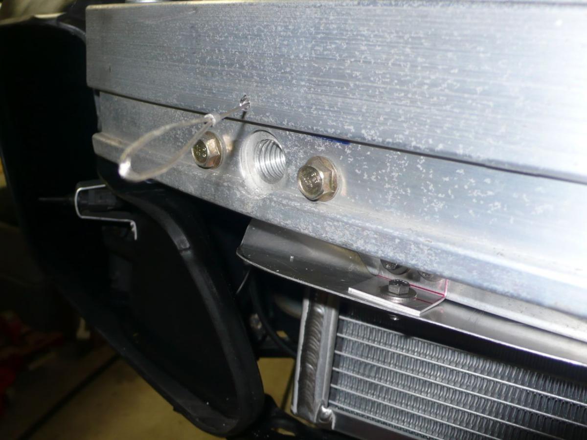

I had an e-mail chat with Loren to discuss where the end/loop of the Stainless Steel emergency trunk release cable was? Loren said it should be somewhere between the right front fender baffle and the bumper. However what he had done was to attach a fishing line to the loop and attach the line to the plastic bumper plug. I took it one step further and drilled a 3/16" hole directly above the tow eye threaded hole in the bumper. The S.S. loop will just fit through the 3/16" hole, then tied a fishing line to the loop and the other end to the plastic bumper plug. If you brought the S.S. cable through the tow eye threaded hole then you couldn't screw in the tow eye.
There's a step on the back side of the bumper so you have to position your drilled hole to avoid the step... At least now I know where the emergency cable is, plus I don't have to remove the tire and maybe the fender baffle. Anyway, chalk one up for Loren.

Nice. I like how you did that. Since I don't track it and, thankfully, my TT is very reliable, I don't really use the tow hook hole. I do, however, use it to hold my front license plate when I get the occasional "no front license plate" fixit ticket.
