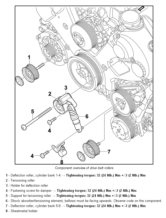

Torque values for 2005 CS' two belt "Deflection" Pulleys
Engine is getting noisier. Doesn't idle quietly anymore. Hopefully its just the serpentine belt pulleys and not the generator, AC compressor, water pump or power steering pump. Or the belt tensioner pulley. I can't seem to find the torque values for the two deflection pulleys, can anyone help? I found the pulleys online, cost OK, but I first have to remove the belt to find out what is causing the noise.

Loren, thanks for the update of the torque values. Always appreciate a good diagram. Use to take drafting in high school many many moons ago.

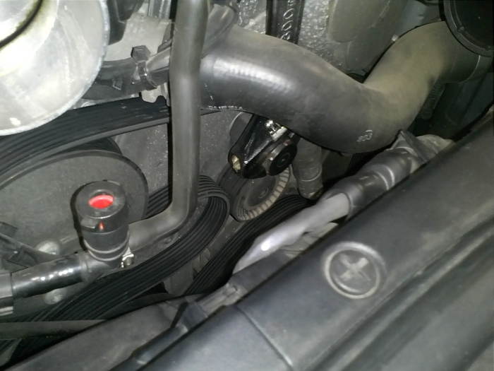

Update: Loosened belt, then checked pulleys, power steering pump and water pump (couldn't reach far enough to check AC compressor and generator).
Result:
Water pump and power steering pump pulleys: no play and rotates OK (far from a thorough inspection but seems OK).
Left and right pulleys: rotates OK, left one has no lateral play, right one has minute play.
Tensioner pulley: Rotates TOO freely, eg. spin it with my fingers and it would spin for about 10 seconds before stopping, this to me means there is no lube inside where the bearings are to allow it to "free wheel" for such a long time. Of course, since I don't know what a new one is like, I am just speculating. There is about a 1/2 a millimeter of lateral play... a little more that what "feels" right.
My conclusion: A bearing in good condition should have enough lubricant in it so that a pulley won't be able to spin so freely. This means the tensioner pulley needs to be replaced. ECS Tuning has it for about $37.xx plus shipping. I will report back when I install it and hopefully, this was the cause of the noise.

post-88071-0-89282400-1385835391_thumb.j
12" adjustable wrench to loosen the tensioner, just long enough for leverage. Home Depot 30mm box wrench was about $12, longer for leverage.
