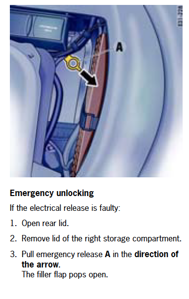

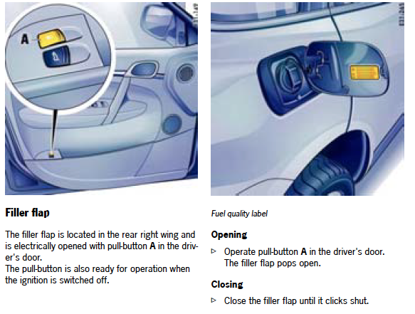

Not sure i follow you 100%.
The door can only be opened when you use the switch on the door. If that fails then you can pull the safety cord.
You should be able to put a volt meter up on the wires and get someone to hit the switch to see if you have power to the solenoid. After checking the fuse of course. If no power then it could be your door switch isn't working.

There are no switches to open my fuel door as you have listed in picture #2. Mine only unlocks with the remote or door unlock. I problem is that the actuator isn't pulling the metal rod back to allow the fuel door to pop open once you push in on it. When I lock it, everything works fine. I have to do the emergency pull for the actuator to move on both the old and the new parts.
Anyone have any ideas? I have checked the fuses under the hood and both left and right sides on the dash. The switched out the actuator and still same effect (the actuator will lock the fuel door but not unlock, with the door lock or remote). Tricky!
