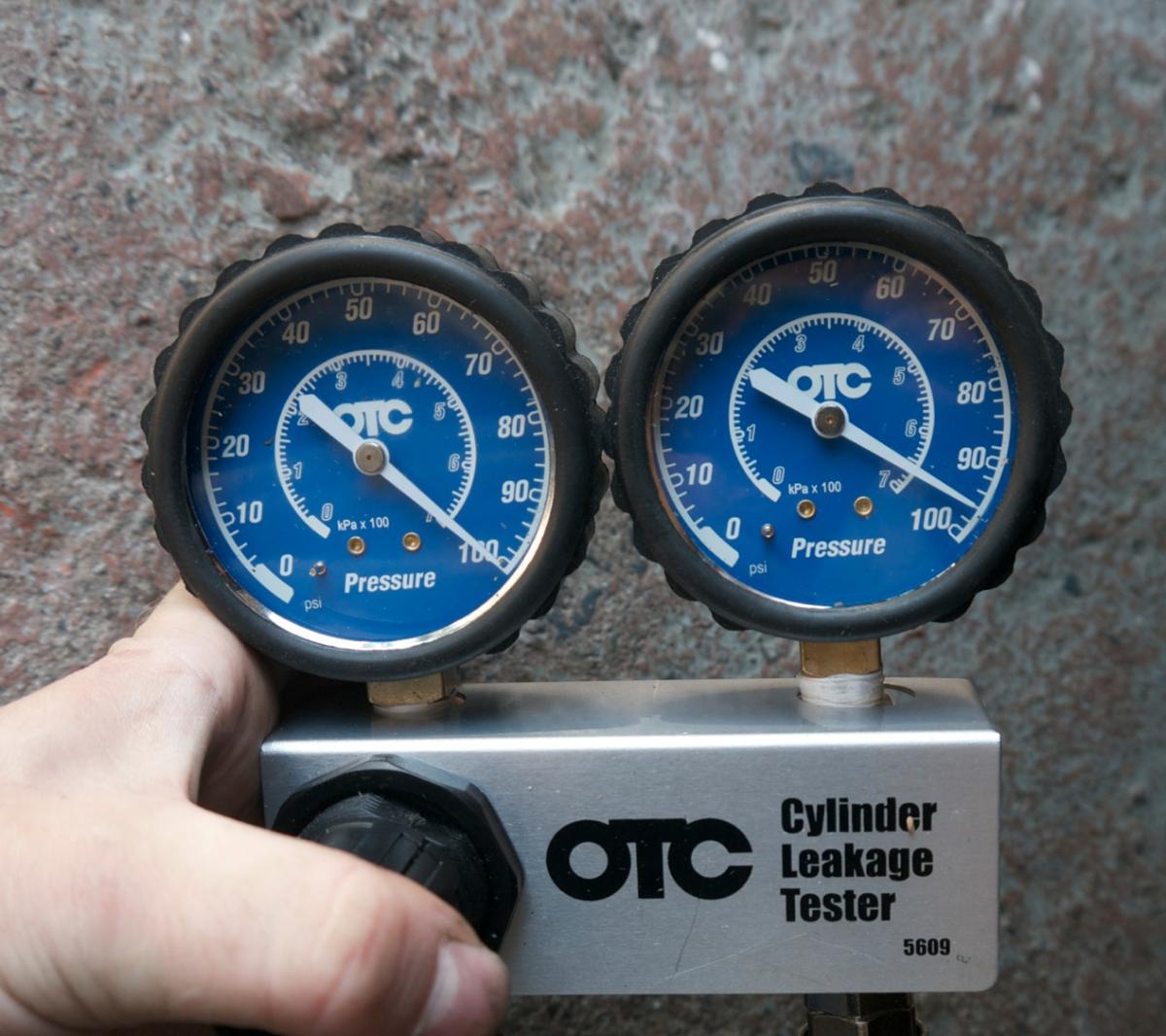

Breaking news, I performed a leak down test but please note that this was done on a _cold_ engine without oil inside it (engine temperature 30C / 85F).
Cyl #1 = 83 / 90 PSI
Cyl #6 = 77 / 90 PSI
Cyl #2 = 84 / 90 PSI
Cyl #4 = 38 / 90 PSI (intake and exhaust passes air)
Cyl #3 = 28 / 90 PSI (exhaust passes air)
Cyl #5 = 84 / 90 PSI
Great :huh: Bad values in both banks. After my last cleaning session, cyl #4 improved around 10% but that is insignificant. I have not rigorously cleaned cyl #3 yet, but based on my borescope session, it should be reasonably clean, hard to see the places where valves actually tighten themselves against the head, I might get it better but too tired to engage into that adventure today.
What do you think I should do?

Assuming there was nothing wrong with the engine or its leak down values before your experiment in towel inhalation, it would be a fair assumption that the values on cylinders 3 and 4 are as the result of the clean out campaign (either residual towel, loosened carbon, or a mechanical scratch on the valve seat somewhere). As cold leak downs are notoriously inaccurate, and because you are going to be facing a major cash outlay to pull the heads off and send them out for a retread, I would be of the mind to put the car back together and light it up, assuming there is nothing visible left in any cylinder or head runners. Once warmed up, I would specifically look at the leak down of two currently weakest cylinders; if they "heal", you are back in business. If they don't, you are no worse off, or any poorer, than you are currently.
I'm with JFP. Given your circumstances it's clearly the best option.
Once it's warm, rev it up a few times past 4k. If you've got valve issues, you'll most likely hear a miss or a backfire especially on decelleration.

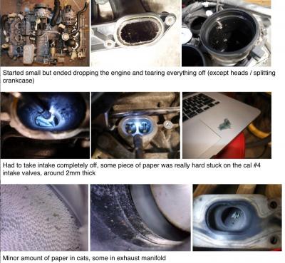

Some background info follows..
Everything in the engine looked really clean, I even used a small USB microscope to inspect various places when IMS and chain tensioners were out. Also filter and oilpan was really clean.

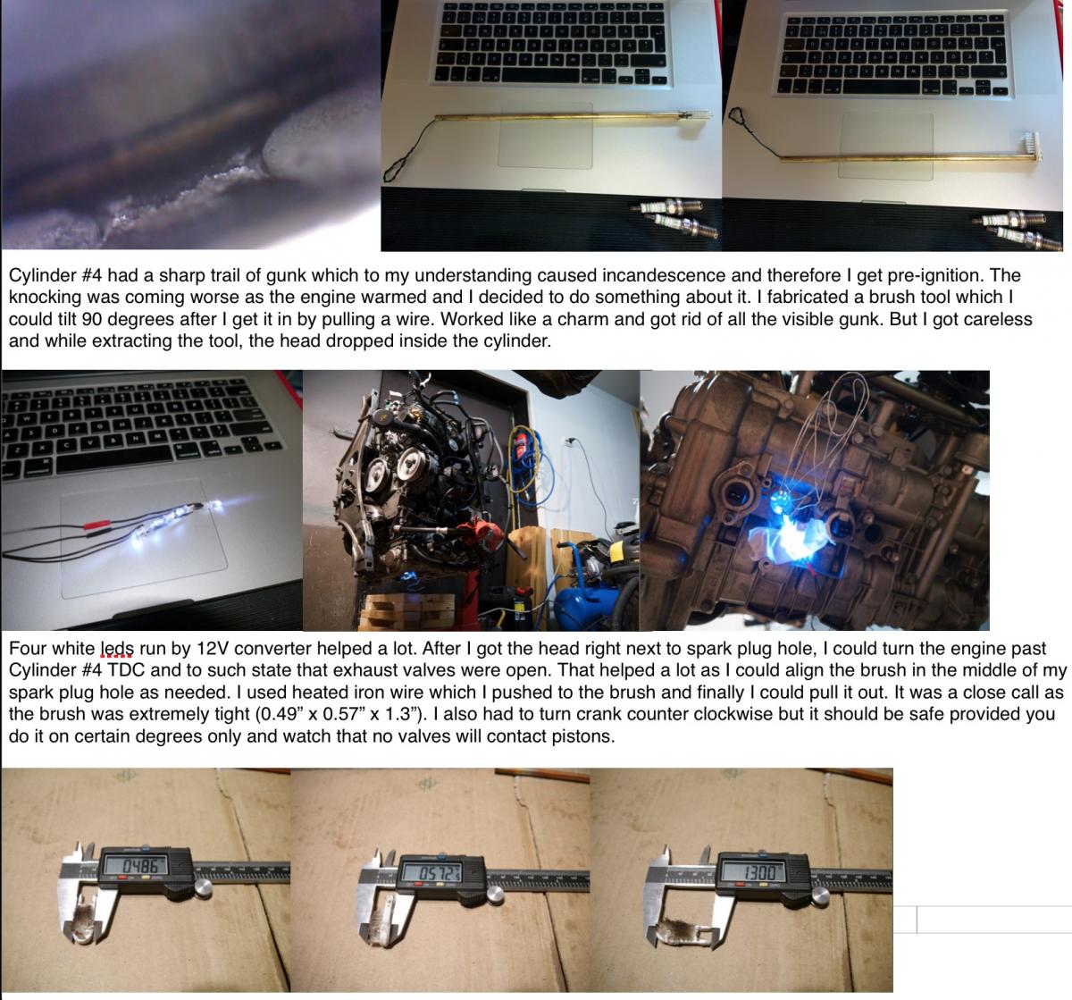

Breaking news... I decided to take one more borescope run with a better mirror alignment and noticed that the area between my exhaust valves contained a sharp trail of gunk. I suspect that this causes incandescence and therefore pre-ignition. The sound of my bank 2 just kept getting worse as my engine warmed up.
I fabricated a brush tool which I could tilt >90 degrees after one pushes it through the spark plug hole, when I pull the wire the brush part tilts >90 degrees. Worked like a charm and I got rid all of the visible gunk. However, I got careless and while extracting the tool, the brush head dropped inside my cylinder. Game over. (I now know how to do it right though).
Next I soldered some white leds togethers which I could insert through the exhaust valves and see the battle area. Using wires I could align the brush to the only position in two axis that I could extract it. With the help of pushing down the cylinder, I got it jammed inside the spark plug cylinder and finally using hot iron and copper, pull it out. The piece was 0.49" x 0.57"x 1.3" but the brush part compresses somewhat.
Should you be interested of this insane journey, see the ludicrous pictures on my attachment :P
Hopefully I have the time to put my engine back soon and fire it up. If this does not help then I'll give up, extract bank 2 head and ship it to a shop for proper maintenance.
Necessity has always been the motherhood of invention, so congratulations on inventing yet another new Porsche tool! :thumbup:

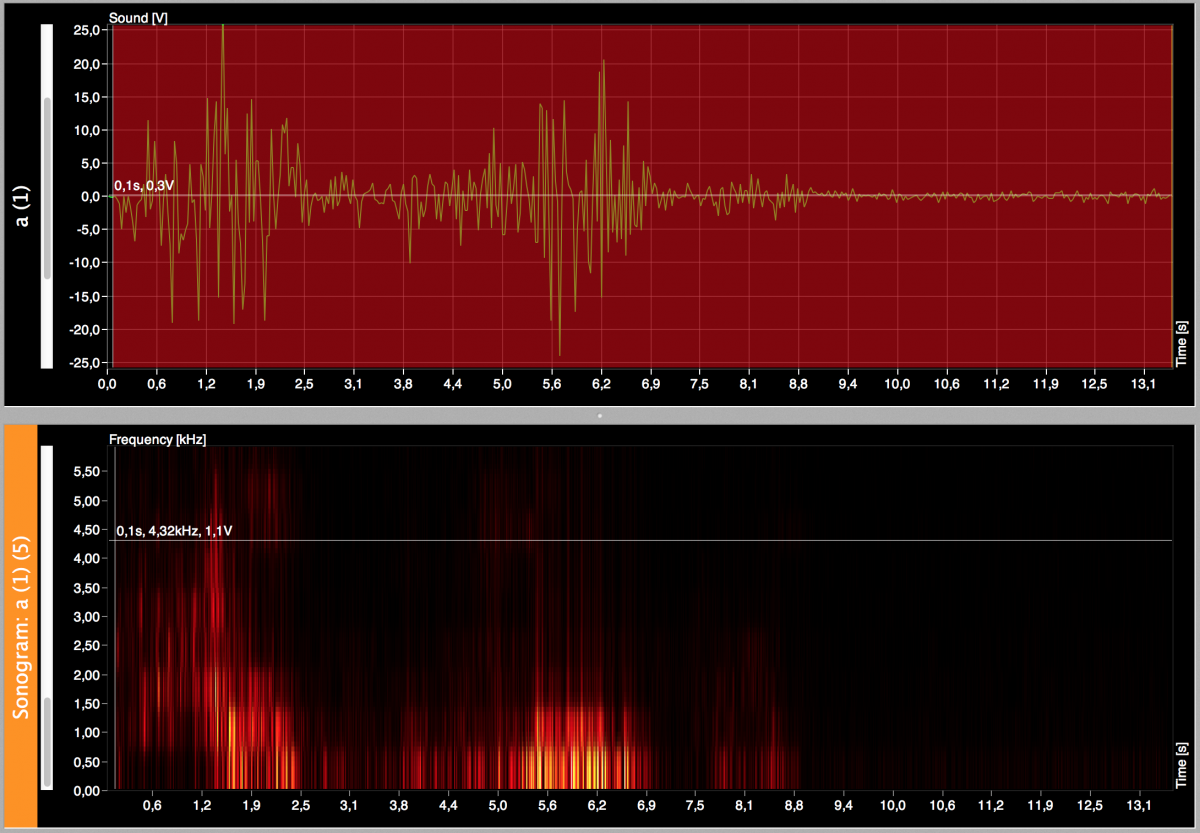

Huge cleaning work behind for cylinder #4. Today I managed to get my engine and transmission back, started my engine, warmed it up to op temperature, took a short 5 minute drive. No error codes. After shutdown, I performed a leak down test for cylinder #4. Result was 100 / 96 PSI, which is excellent news (most likely worst case scenario no longer applies) :clapping:
While running, after idle dropped to 700 RPM, bank 2 is still giving out a nasty knocking / pinging sound, not as bad as previously but noticeable still.
Any suggestions what to do next? :) What fields should I log using Durametric?
My schedule is hectic but I have free time this Tuesday evening. I plan to warm it up again and perform leak down test for all cylinders. I suspect all my other cyls are good as the paper was stuck on cyl #4. It can be that some parts on my camshaft (valve lifters or such) did not like paper getting stuck.
Please see a quick 30 sec video here: https://www.youtube.com/watch?v=uLSUKtKnlkk

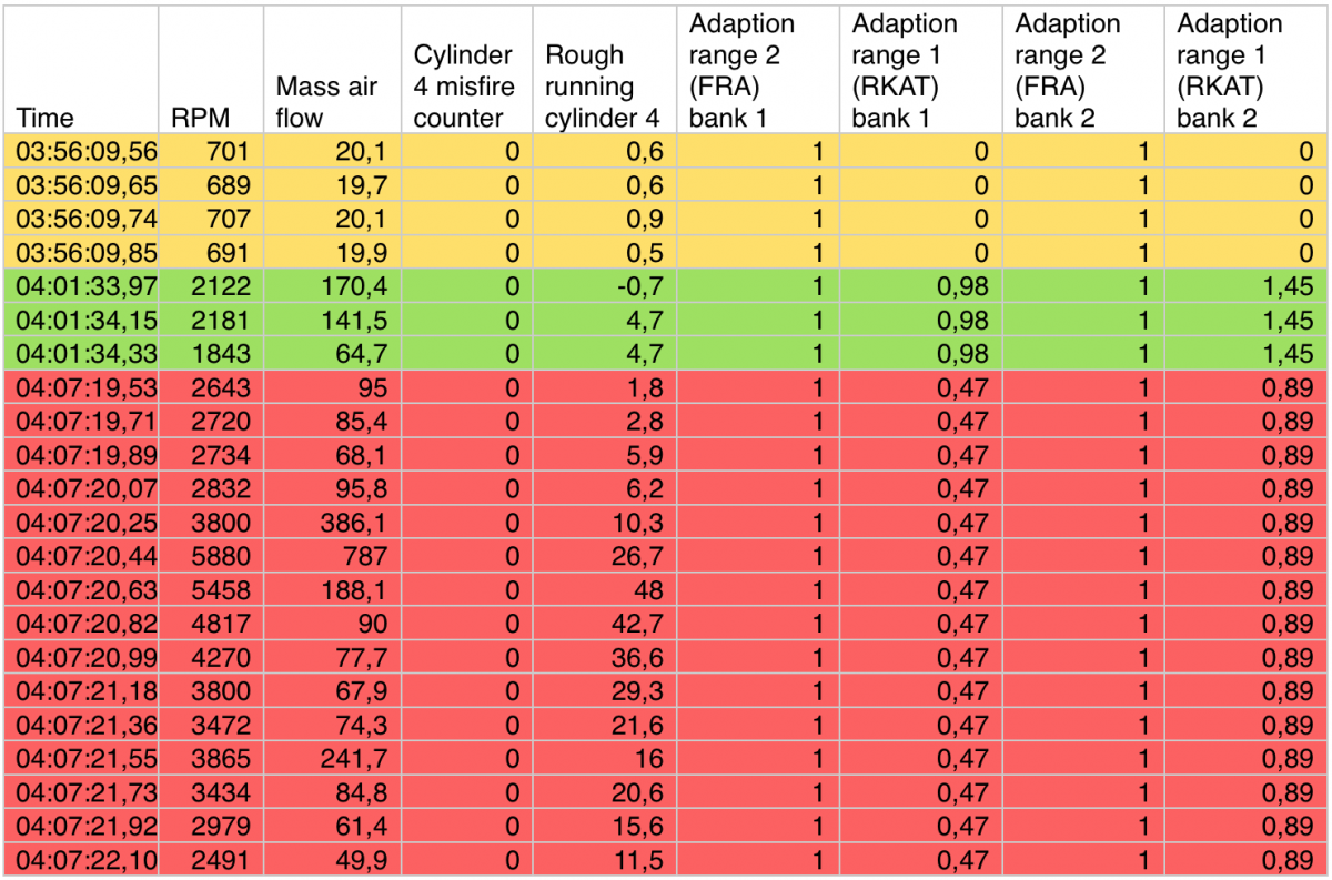

Forgot that I did log some Durametric values, here's a simplified version of it, small snapshots from three different time periods. First soon after the start (yellow), three minutes after (yellow) and finally over 10 minutes from the start (red). Rough running on cyl #4 gets quite high values, are those OK?
Camshaft position deviations are good: worst values are 0.66 and 2.05
I'd be happy to know which values I should log to diagnose this further, suggestions are welcome.
post-93239-0-20666600-1402251541_thumb.p
Also, since last run I changed my injector o-rings (12 pcs), re-attached intake and exhaust parts again and moved across the following parts between bank 1 and 2:

Those Durametric numbers look fine. However, if the DME has been reset recently, 10 min may not be enough to get a steady state values. The best is to drive the car for a while say half a day then re-measure everything. Also the MAF reading of 20 kg/hr sounds high at 700 rpm. I think it should be around 15-18kg/hr.

Thanks for checking my data out.

Any ideas what to log with Durametric?

BTW, here's a sample spectrogram of my 996 start with old tensioners. The rattle can be "seen" in between 5,0 and 6,9 second interval. You can see that after around 9 seconds (cranking included), the engine is running smooth. First few second spikes are due to cranking, the following ones due to "rattling" which occurs with any 996 engine to some extent.
Requires some tweaking with software to filter out normal engine sound but quite easy to do. After I changed my tensioners and oil, the rattle is easier. Then again, the rattle was quite OK even before. Anyway, to do this properly, one needs to repeat recording and analysis in exact same manner before and after changing parts. This is just for the fun of it, not that scientific :king:
I could let someone else drive the car so that I can do some Durametric testing and ensure that knocking is not getting much louder, also with the help of spectrogram.
