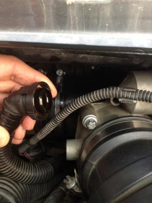

hello
AOS Was changed twice ( this year ) still smoke coming out from the exhaust ( sometimes left sometimes right and both.
Also still the presence of the amount of oil inside the plenum and throttle body
The most important question
What's the reason for the oil get into plenum/throttle if i've changed AOS twice since last DECEMBER !!
vents and hoses all are ok

Very simple: When the AOS fails, it tends to pull a lot of oil into the intake system. There are a myriad of little nooks and crannies where the oil can sit in the intake, so it comes out very slowly over time causing prolonged smoke unless you pull the entire intake off and manually clean it out.

thanks for your reply
throttle and plenum has been cleaned twice
the problem is The oil in TB/PLNUM bcoz of oil coming from vent line and drops in the intake
What is the reason for this amount of oil seep out from AOS Through vent line Which cause the oil in TB/intake
As I mentioned above to aos Was changed 2 time
Is because of bad ring ?

Unfortunately, most of the oil from the AOS is inside the intake runners them selves, not just the area behind the throttle body. To get it all out, you literally need to remove the entire intake system and clean it manually. If left alone, it will burn off over time, but how much time depends upon how much oil is in there.
If they changed the vent line when they did the AOS, there should be no oil in it. If it is a new vent line, and it has oil in it, I would suggest getting a leak down test run on the engine to make sure it is sealing tightly.
we didnt change any vent line just the AOS
i will wait some days and see
thanks JFP
When you get an AOS going south, you really should change everything connected to it as there will be built up oil residue in them. People often skip this to save money, but it is false economy because you usually end up going back and changing it later.
