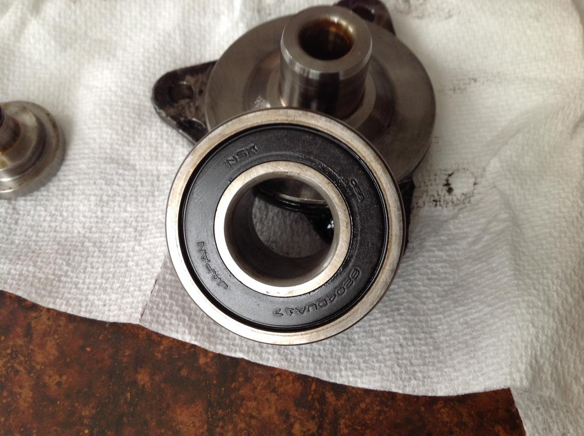

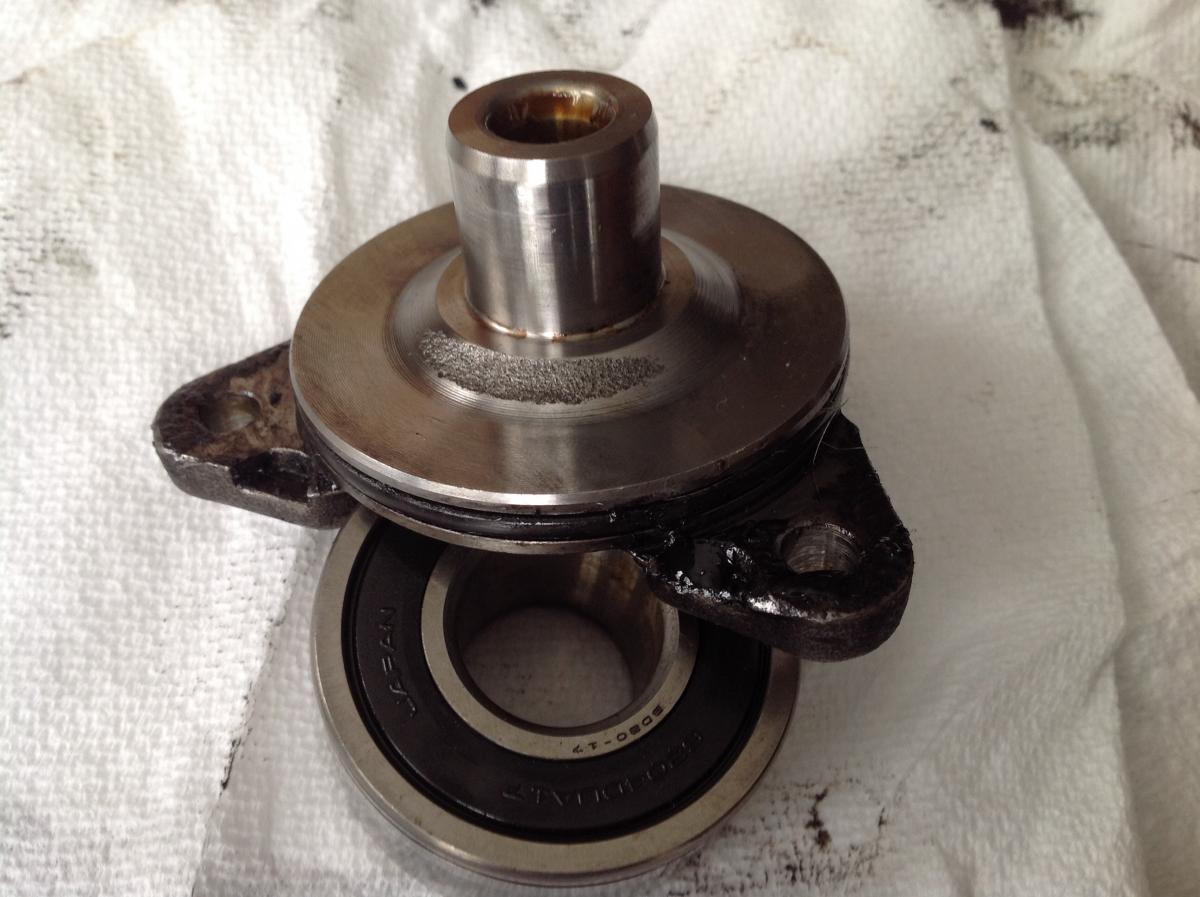

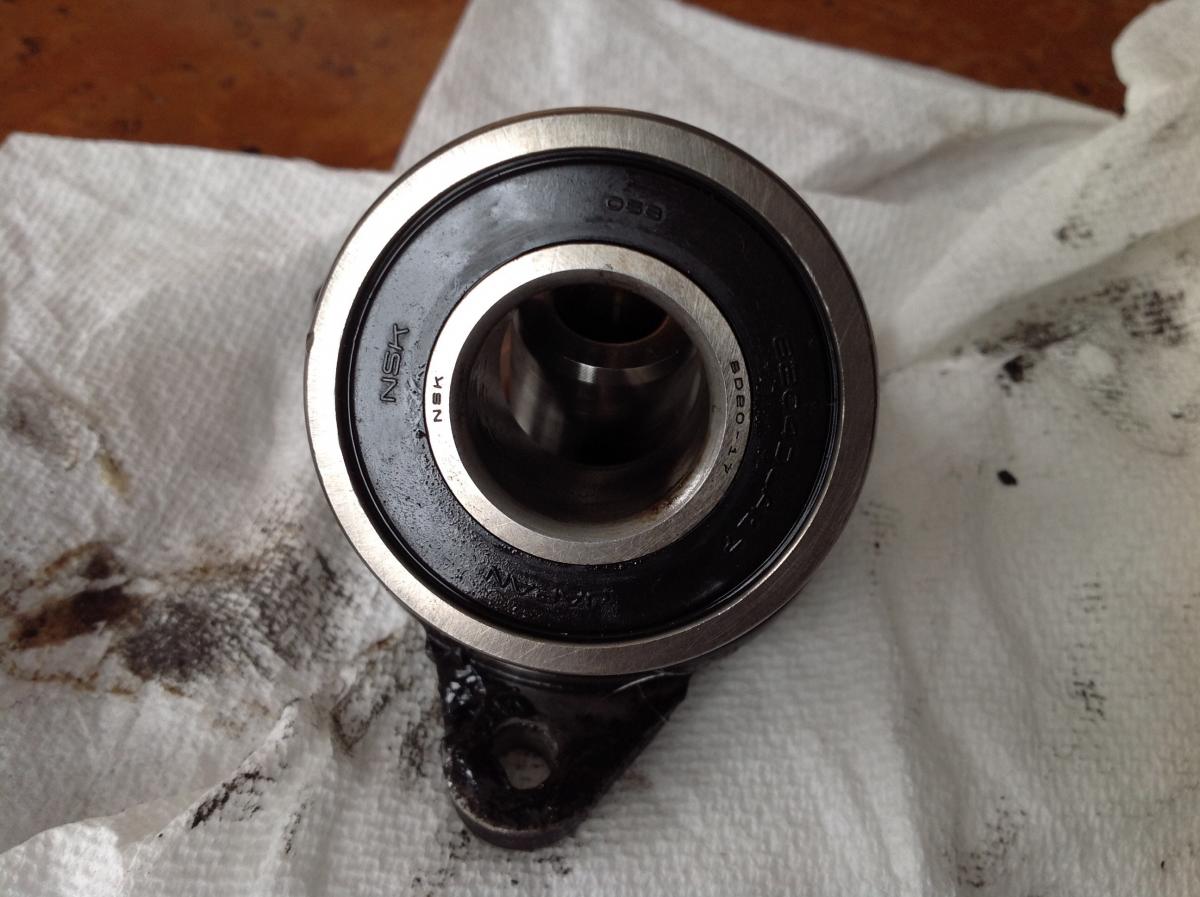

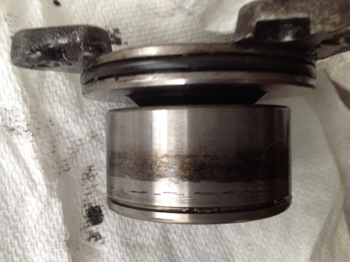

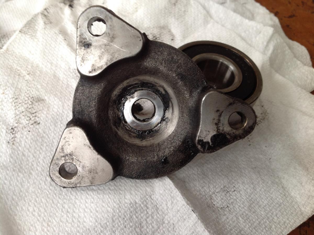

I pulled the IMS from my 996 (1999 C4) and thought I'd let everyone have a look. The dual row bearing spins smoothly and has zero play. The shaft it rides on looks good, too. The cover has a rough edge inside, but that surface does not contact anything. Strangely, the cover has no markings. Most that I've seen photos for had "Germany" or a part number on them. The rubber o-ring is flattened and definitely shot, which I'm sure contributed to the leak I found. I've got the LNE kit to replace the bearing.
So, jury of my peers, what are your thoughts on this...
Did I just spend $$ to replace a good part?
Did I just save my engine?
Does the personal learning experience alone justify the similar-to-3-credit-hours cost?
I really want to pop the seal and look inside, but in order to have the LNE warranty, I need to send them the bearing. What would Jesus do??
BTW, sorry to those who saw this over on the 986 forum, but I'm looking to get as much info as I can.

Congratulations on taking charge of this potential nightmare. Too many of us 996 and 997 owners are procrastinating and as a result not enjoying these otherwise great cars. Seems to me that a new bearing from whomever together with a DOF system is the way to go. I would personally prefer the DOF system that feeds off the oil filter (rather than of the head) but as I understand it it's not available to the DIY. In my case with a 997S, I don't have the luxury of replacing the bearing so I am going to feed the DOF from Tuners RS from the LN spin-on oil filter adapter already installed and I'm also going to put an oil pressure gauge to the oil-line. **** the torpedoes-better than nothing. M2CW
Johan
OH, sorry for the rant. Got a bit off topic. As to your question on popping the seal, seeing that the bearing is not noisy you know that there won't be anything in there. So let LN have it.
Johan
Forgot the mileage...76,000.
Not too surprising the original bearing is still good. Most ppl who changed out their bearings experienced the same. It's a preventive measurement and rarely you see ppl catching a bad original bearing. Anyway, it's done now and that should give you a peace of mind.
I replaced my bearing @ 105K (and a bunch of other stuff, chain guides/tensioners/tensioners pads/water pump/AOS), I pulled the seals and cleaned all the oil out, it runs smoothly, but without the seals the cages rattle. I now have 45K more miles on the LNE and happy I replaced it almost 4 years ago.
I replace mine with an LN at 50K along with clutch and RMS, and now have 72K and have no fear of making a thousand mile trip at any time....I agree with Ahsai, get the peace of mind.
