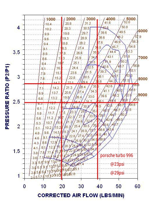

I did some works for new turbos for my 996 at different psi
what every body think about this turbos and what is the power for my stock 996 will gain on the wheel ?

When altering the Turbos or waste gate controls, you can only "guesstimate" the power level changes; what you need to do is test the components on a prober chassis dyno to find out what the real numbers end up at.
