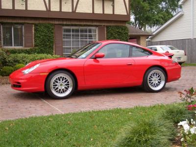

The manual shows a 265/35/18 on a 10" rim for the snow tires. That's actually the size I have on my car because that's what the previous owner had on there. I also have a 225/40/18 on a slightly larger (8.5") rim on the front. I like the look of the slightly rounded tire because it's like the Viper I just sold.
Here's a pic...
