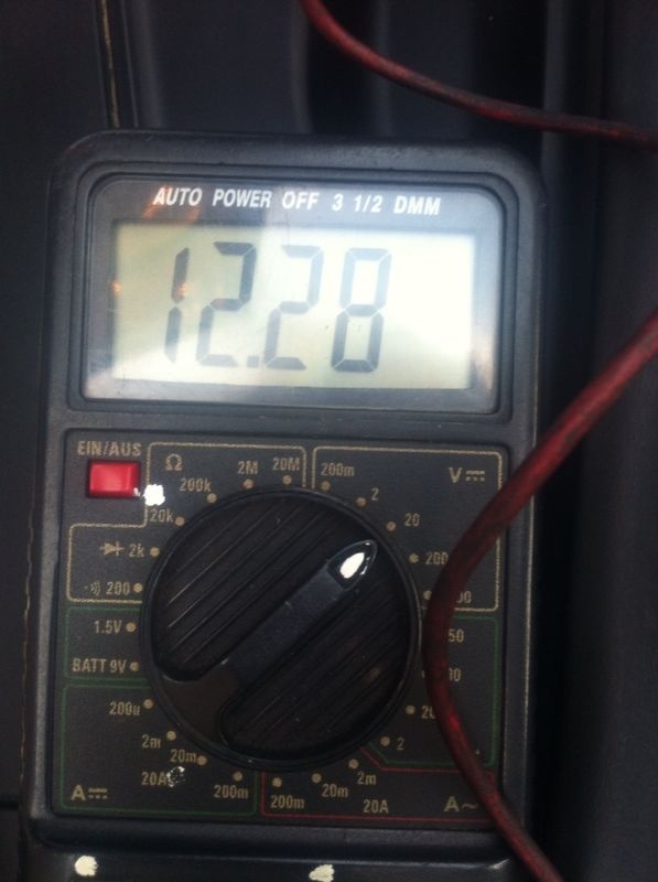

Here i am again. I try some things today because the car is still at home.
First of all, i dont have a second battery in the trunk.
After replacing the new battery last weekend the car stay all week without driving.
I open the hood and tested voltage in engine bay plus / minus port.
Reading was 11.30
I try to start the car. Starter turning but engine not starting.
Using my s to make a jump start. Car is starting and running.
I left it for some minutes running, drive a few kilometers and shut down the engine.
Waited a few minutes and tested the voltage again.
Reading 12.30
I started the again
Reading 13.96
Does this test show me that the alternator is ok and working
Proper? Or is it possible that a mistaken alternator also would show
This reading?
Thank you again
Sorry for my mistakes. I am writing on mobile phone.
Multileter Reading with engine shut down
12,...
Multimeter Reading with running engine
13,9......
Your voltage is too low, should be between 13.5 and 14.5V with the engine running, you are reading battery voltage so either the alternator or voltage regulator (inside the alternator) is bad.
What's the voltage reading if you turn on the headlight, the a/c, and the rear defroster at the same time during idling? If it's below 13.5v, your alternator is likely bad. That's a crude load test before you can get the alternator tested properly at the shop.

Yes the battery was only 11.3 after some days the car was not moved at all. You are right, There is some drain for shure.
The high reading of 13.96 was with ac, headlight. Radio, defroster on.
In that case, you need to track down the drain first. Otherwise your battery will keep draining and alternator keeps stressing out recharging the depleted battery. Very bad for both the battery and the alternator.
