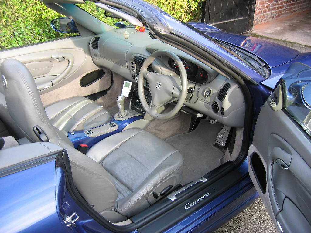

So......for the small cost of buying a used black one on ebay and several cans of paint, primer and clearcoat.....and a very dust free room.....and a lot of patience......I painted my own console.
I must say it is a very good job. Not one Porsche owner has yet said "Oh you painted that yourself then". In fact even my OPC say it's as good as the ones they supply. It has been on my car now for about 6 months and has no scratches or cracks appear and it seems to be very hardy. In any case, for the cost it was well worth the experiment and if for any reason it goes horrible on me in the future then I will just put the old one back on.
Sand it down first and finish off with a light sanding. Needs to be very smooth and the old paint mostly removed but not necssarily all of it. Clean with white spirit and let fully dry. rub down one more time with very light sand paper. ENsure final surface is dry and dust free. No harm to go over it with another light wipe of white spirit but let fully dry. Use 2 coats of primer. Prime very lightly not heavily. Allow overnight between coats. Lightly rub down with sand papaer and wipe off excess dust with light spray of spirit. Then 3 coats of paint. Again very lightly between coats and let dry for at least 48 hours between coats. Use the finest grade sand paper and very lightly rub down the surface. Then a final coant of paint. Leave for a week! then 2 coats of clearcoat. Leave for a further week and bobs your uncle!
Yes I know, why this and why that. Well I don't know but that's how I did it and it worked fine for me.
BTW, my colour is difficult to work with as it is a pearlescent metalic Zenith Blue. If I can do it anyone can do it. But I have to admit that if I lived in the US, I would not even begin to attempt this since Eric is da auto paint guru.
