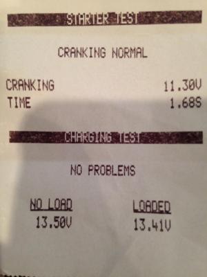

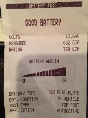

I don't think a wire was loose when I reinstalled the electrical portion of the starter. I did that last August and have since driven the car 25k miles with no issues. I took the car to get the battery tested and attached are pictures of the readout. I do not think I had the lights on when I had the power dropout on my radio/instrument panel with the car off, but ignition left in the "on" position. The most baffling part was the dropout with the car not running.
Why does the reading say "Good battery," but the "Battery Health" is rather low?

Have you checked if the battery ground cable and engine ground cable are tight and without corrosion? Maybe replace the ignition switch again? These problems happened (much) after the ignition switch change, right?

How old is your battery? Your battery is ok but not great. It has lost 10%+ its designed capacity. My experience is a new battery usually measures higher than its CCA spec, then after a few yrs it will lose a can be a few %. My 2 yr old 700 CCA battery still measures 680. My car is a DD so it's quite battery friendly though.
