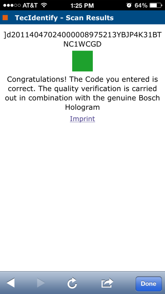

In troubleshooting a rich at idle, lean at speed issue, I replaced my MAF with a yellow boxed one. As far as I know the one replaced is the original. Since there are so many knock-offs, I used a reputable vendor and double-checked the authenticity. Essentially, you download the TecIdentify app on your smartphone and scan the 2D barcode. After scanning you get a green verification or red problem screen.

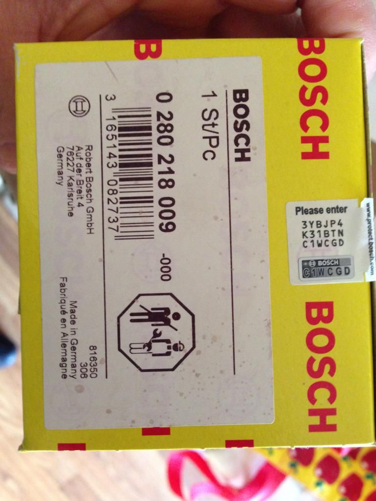

Look for the seal on the box with codes and Bosch Hologram:

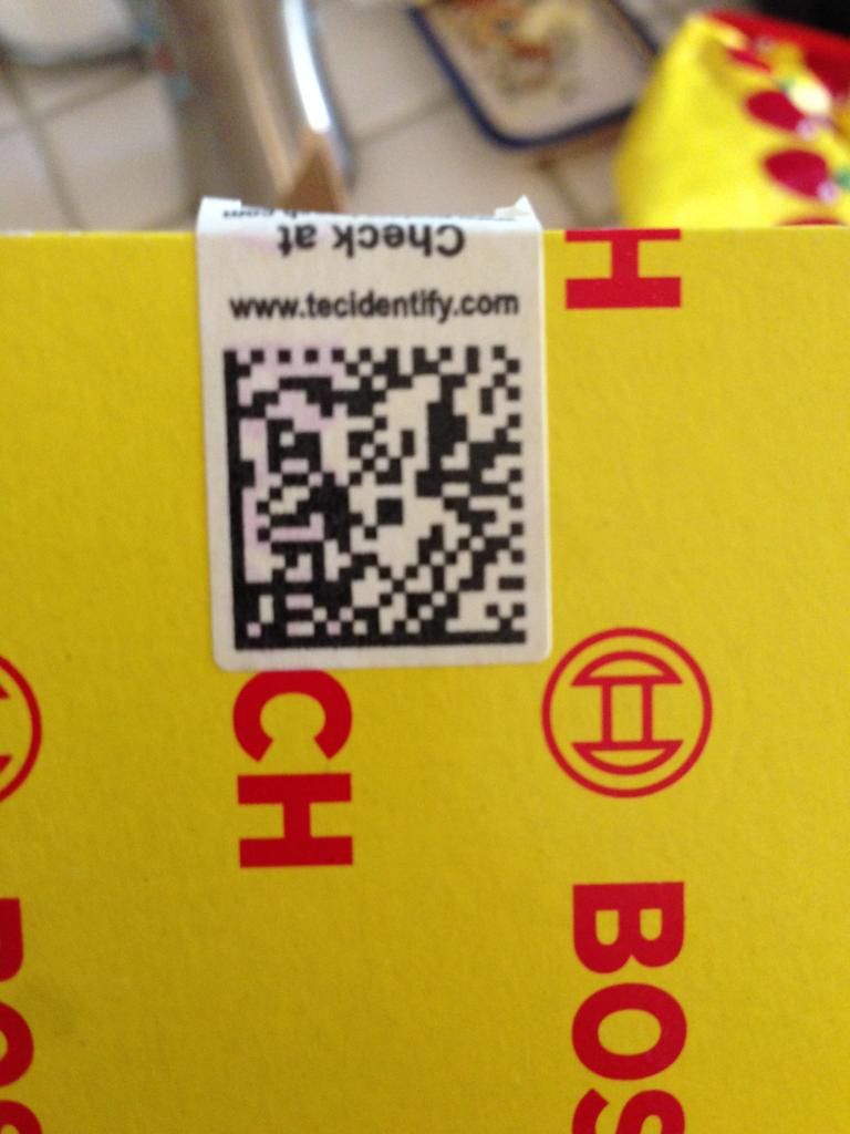

Download, the tecIdentify app
Find the 2D barcode on the other side of the seal and scan it:
Look for a green square in your verification page of the app:
You will notice the code submitted matches includes the 3 groups of codes printed on the seal (3YBJP4 K31BTN C1WCGD) and the last group of characters is duplicated in the hologram.
