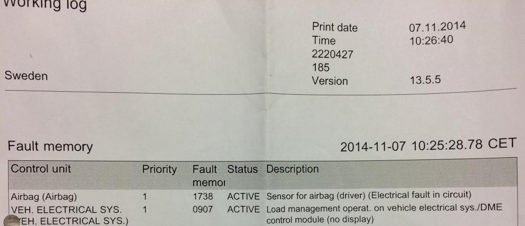

Hey. I'm new to this forum and owner of a Cayenne S V8 2004., I have had error code 1217 and remedied this by soldering the cables, everything worked fine for 1 month. Now I have received error code 1738 sensor for airbag (driver), and seat occupancy, passanger - too big and Resistance battery open circuit. Are there more connections under the driver's seat that can cause a short circuit? I can not delete the error code ... it comes back right away?

Hi. I have been with My car at Porsche Center in Sweden and they told me to by a new air airbag sensor. Today I installed It and with same result. Fult code 1738 airbag sensor ( driver side) I have tried to reset the code but with negativ result. This is hopeless. I can't get the car through the inspection with this ****ing airbag lamp on.

1738 is definitely the sensor on the Front Left (Driver side in US) under the headlight.  Likewise 1739 is the same sensor on the passenger side.  Once you replace the sensor the error and light will go away (i.e. you don't need to reset it).  I just did this fix last weekend on a 2005 CTT.
Btw, getting the sensor off the mount is really difficult if you live in a salty area.  I basically melted the plastic aound the metal collar, removed the sensor and then used vicegrips and heat on the metal collar to remove it from the post.  To apply heat I used and Induction Heater (Venom).
