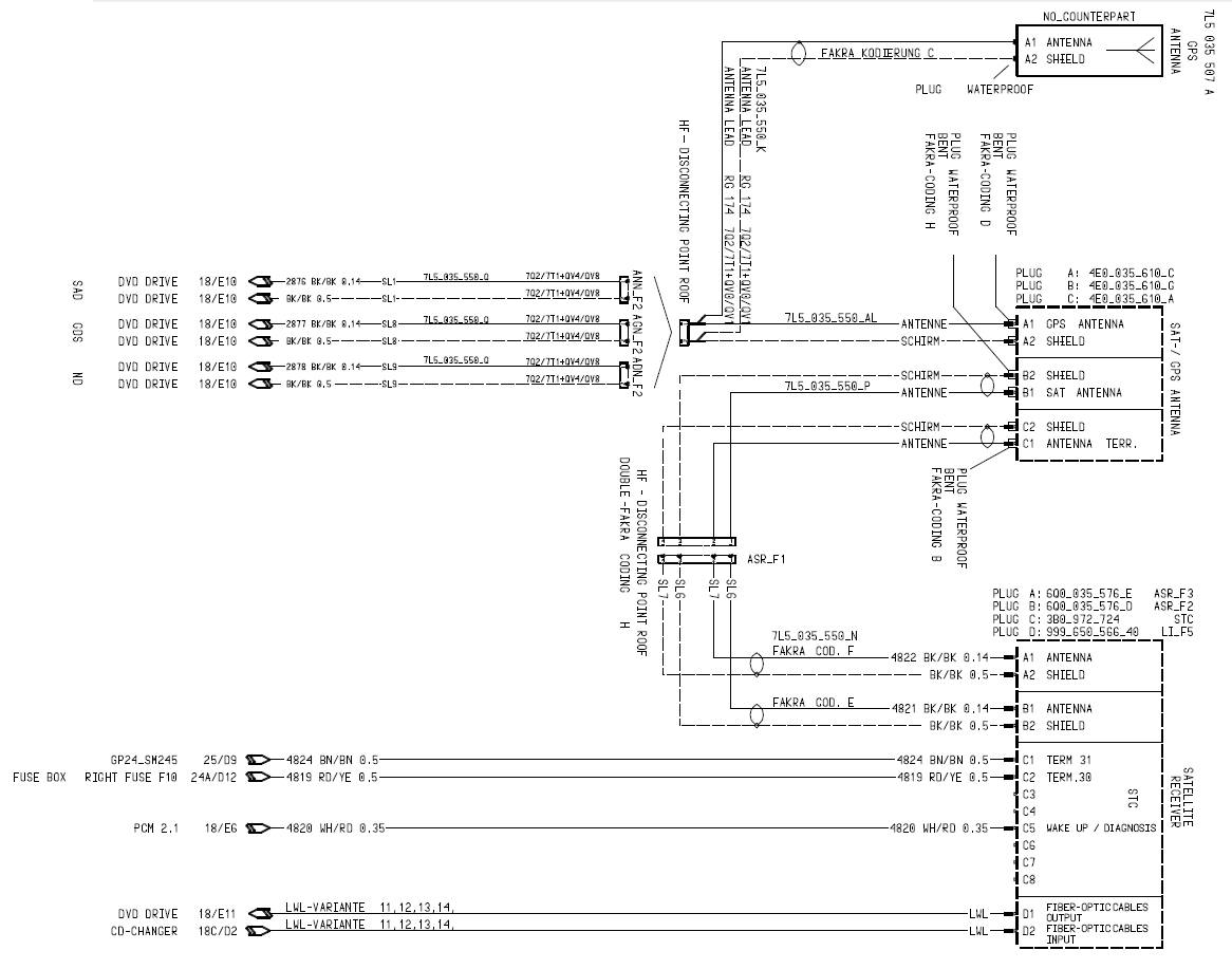

I have 2006 V6 Cayenne with PCM 2.1
I currently have two cables in the rear right compartment of the trunk (one orange and one black) NO CD changer here either. I ended up buying a used XM Delphi module 7L5910563E from Ebay. I also purchased an XM antennae from ebay as well.
The XM module came w/o any cables. Can I just connect the cables in the trunk to the XM module and the antennae and I am ready to go? I will have to figure out a way to secure the module but do I need any other cables?
Thanks

So I received the XM radio module and looks like I will need the wire harness w/o CD changer. Does anyone where I can get that for cheap or where can I even buy it.
Share this post
I am not sure if you need a CD Changer or not as the wiring ( MOST - optical) seems to pass through it. You will also need the antennas.
(click to enlarge)
Share this post
HI,
So I got my 955.044.900.81 Electric wire harness without CD auto changer but cannot seem to connect this wire to the XM module. From the wire harness I connected the power lead to Figure 15A from the TSB but cannot the optical waveguide connection point Figure 16 A because the leads are not male/female. I am really confused. Is there someone on this forum that I can talk to on the phone. I would greatly appreciate it.
Thanks
Please PM me.
Share this post
Okay all....I hope people out there are learning from my trial and errors! :eek:
Turns out that I had not taken out the optical protective cover on the harness wires! Oh well. Live and learn.
