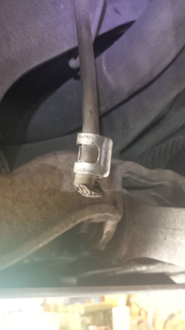

2. During the inspection just finished, I noted a tube (with a clip still on it, and it's end melted) hanging down near the brake on the front right. It wasn't causing any problems, but I have attached some photos in hopes of someone being able to tell me what it is and what to do about it.

My guess is that #2 is your battery vent tube drain. Make sure the end is not clogged from the melting, and the clip reattaches to the wheel well area by sliding the edge in against the metal frame rail.
