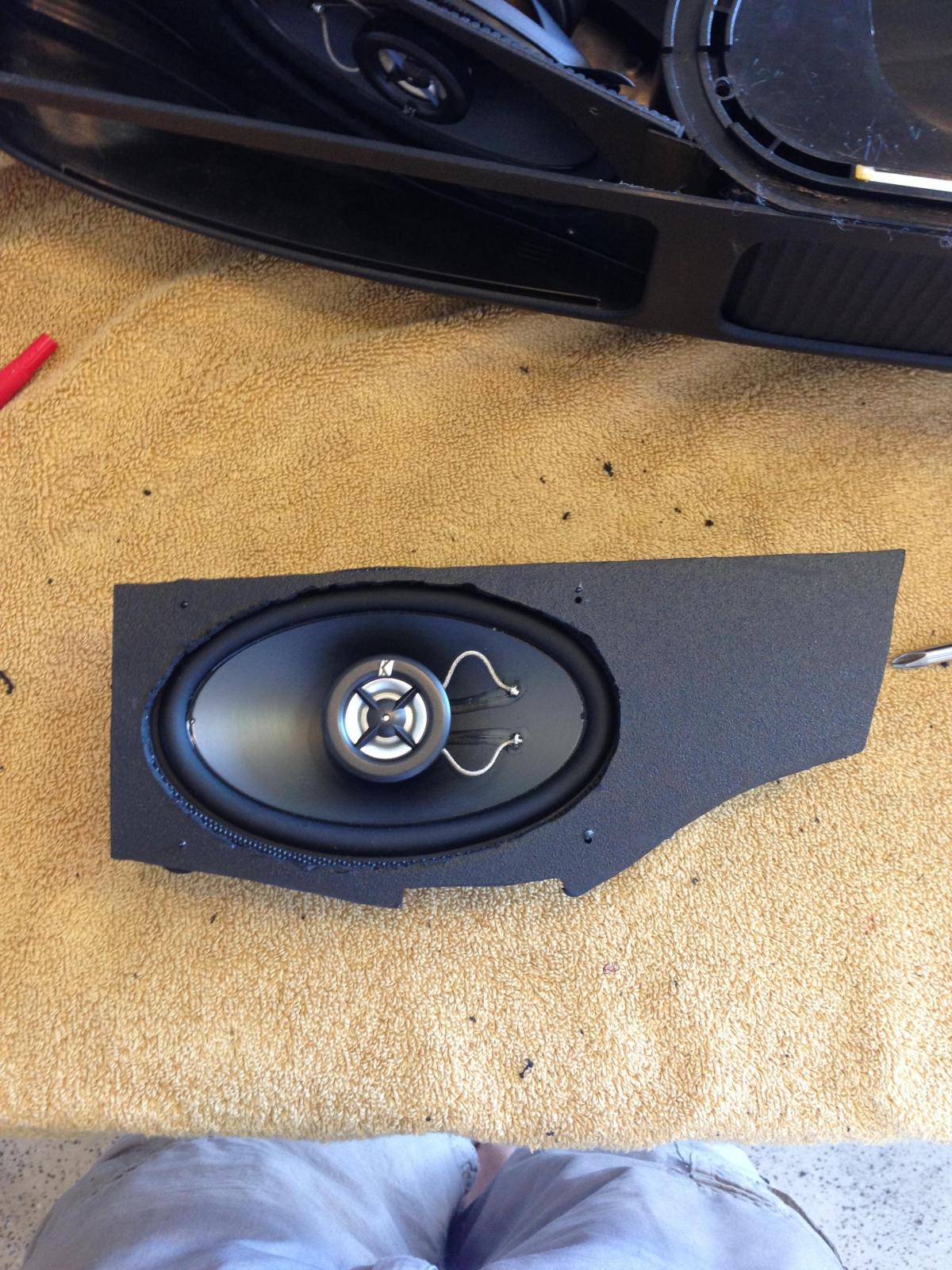

Pic1 - Front view of speaker mounted in plastic bracket (used cardboard to trim to shape then used as pattern on plastic)

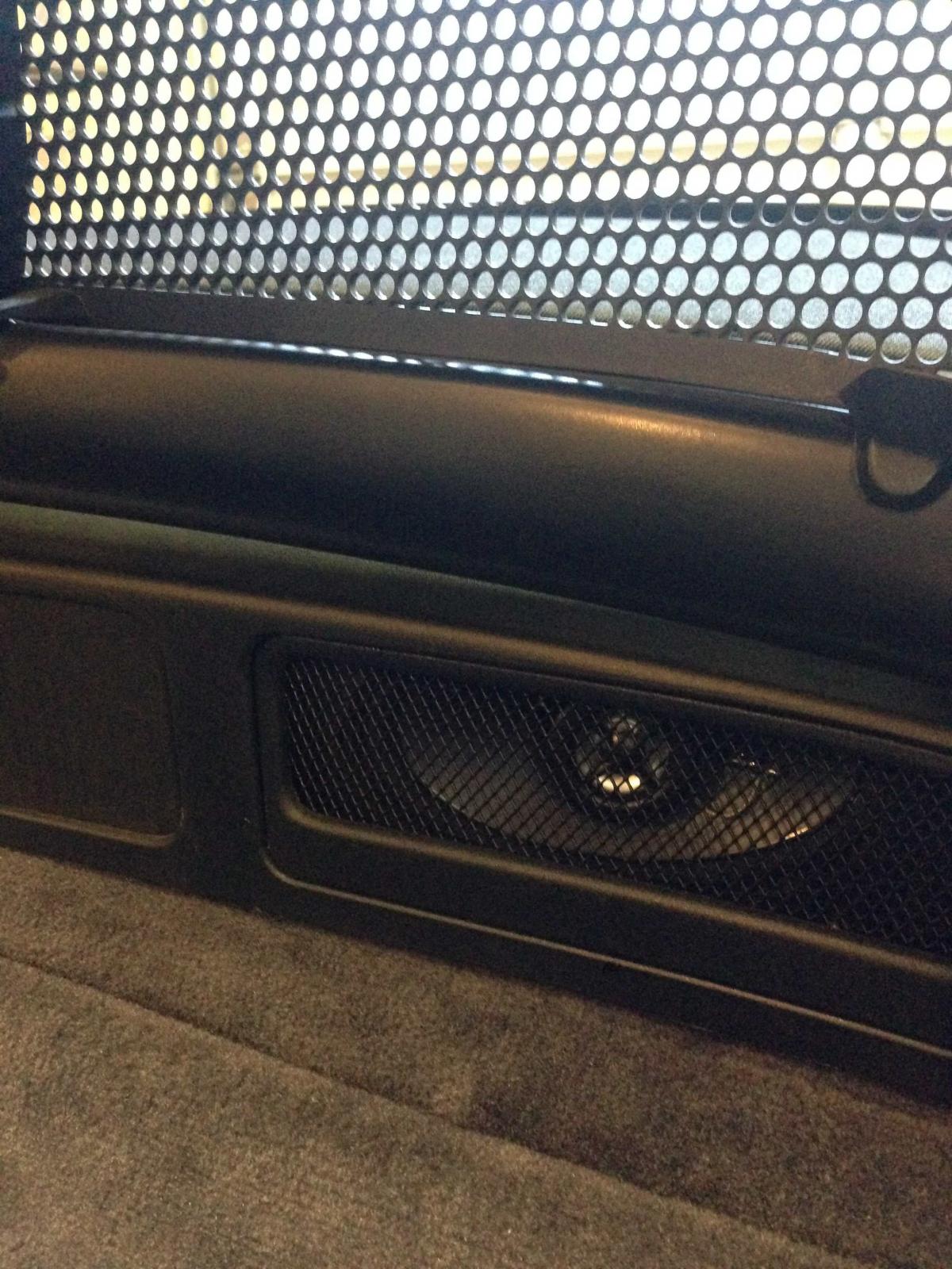

Pic 3 - View installed in rear utility box
Pic 4 - Wire mesh waste paper basket (from Ikea) used to make speaker grills
Pic 5 - Project complete, installed back in car.
Tools / Materials used:
Thin cardboard / Scissors to trim to the correct pattern
Sheet of plastic ($8.00 at car stereo installation dealer)
Wire mesh waste paper basket for speaker covers
Dremel tool (Drill and Grinder tip) to shape plastic and drill out speaker hole
Tin Snips to cut wire mesh to fit
Hot Glue Gun to glue wire mesh to speaker opening
2 Kicker 4x6 speakers ($80.00 at local car stereo dealer)
The sound is MUCH better than the stock front and side speakers, the jury is still out on the sound quality of the kicker speakers.
