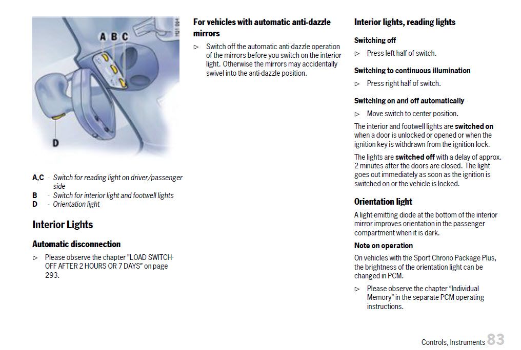

I just purchased a 2007 997C4 Cab. So far the car has been great. I have one question. Both map lights and the interior light will not turn on with the switches in the on position. With the switches in the center or door activated position they work fine with a door open. That means they have power and all 3 bulbs are good. What am I missing to manually turn them on?
I had a similar problem where those lights would not work with the door open. It turned out to a cold solder joint where the switch is mounted to the circuit board. The switch has considerably larger connectors than the other components on the board.....A few minutes with a soldering iron and all's well.
