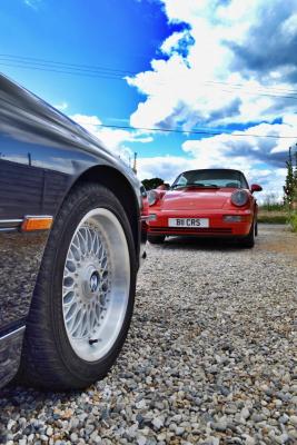

Hello everyone, been snooping on here for a while now but I have recently sold my 1982 SC and treated myself to a 1990 964 C4 in guards red.
Its just been fully resprayed so looks in fantastic condition! Just going to spend some money on new rear lights including the reflector and new front side reflectors just to get the exterior in tip top condition.
