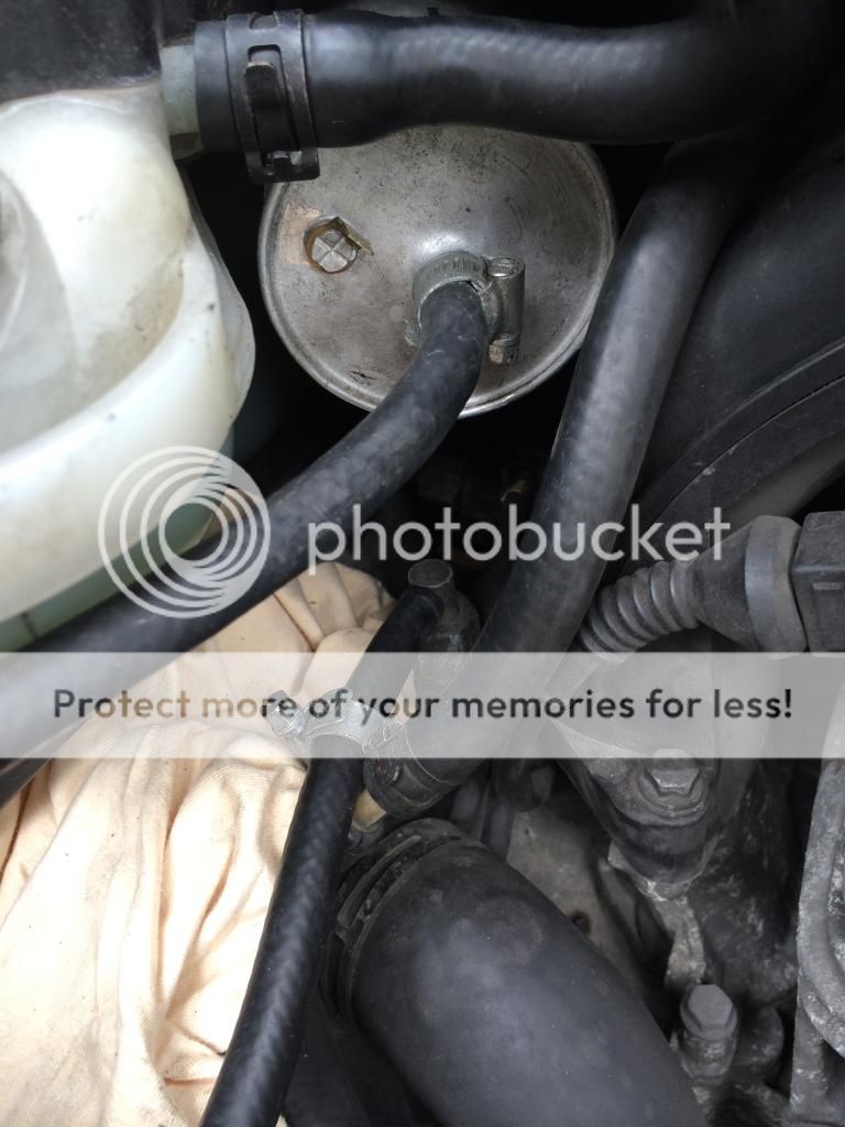

Hi Everyone, I bought a 1999 C4 Manual Coupe about a month and a half ago and went to do some maintenance on it at the weekend but ran into a problem which I hope you guys can help me with.
I purchased the fuel filter 99611025352 (for a C4) with the nut on the end, however when looking at the fuel filter that's currently in place it looks like 99611025301 (for a C2) is there and held in place with a jubilee clip and no sign of the threaded end that should be there on a C4.
So my quetion is does anyone know where I can find the part number for the correct end of the fuel line so that I can fix it properly and not fit another C2 filter there which would annoy me?
Picture of the filter in situ
3466BD78-02C1-4CB5-9003-9836672F3AE6_zps
I think you are looking for 996 201 265 01 Fuel line.
Thanks for that, it's expensive for what it is but it has to be done I suppose.
