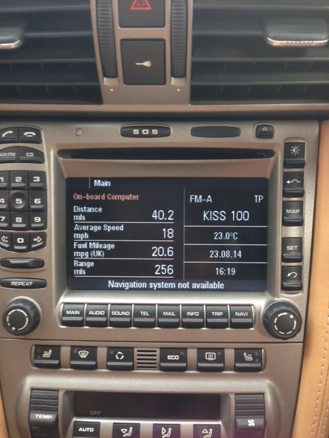

Hello,
I have just bought my first Porsche 997.1 2006 C2 with the PCM system (which I think it is called)
Everything seems to work fine. The CD player works perfectly fine and it all seems good.

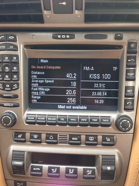

Except for when I press Tel, Mail, Navi or Map buttons, I get the following error along the bottom of the screen
Navigation not available
Map display not available
Internal Telephone not available
Mail not available
Depending on what one I press.
I receive no manuals for the car and bought from a used car place which didn't really no much about Porsches.
Does this mean, I need a CD? or does it not have navigation? or could it be faulty? does it need a sim card for everything to work? Im just lost.
I do not have any CD drives or anything in the trunk but it does have a type of sim card tray on the front of the unit that ejects
Any help would be much appreciated as I really just want the navigation on it.

When you press MAIN and TRIP together, does it show Navigation and Telephone?  Also check your option codes in the Maintenance booklet.  666 is phone, and 670 is navigation.
if you have nav and phone, try a system reset by pressing the 1, 4, and 8 buttons at the same time.
If it does show Navigation, is there a map disk in the Navigation drive?  (In the front compartment, behind the plastic door at the back of the compartment).

No it does not. I then tried pressing 1, 4 and 8 together which done the reset and when It came back on I did the MAIN and TRIP together again which still only showed whats in the photo.
I also checked the trunk and don't seem to have any drives.
I take it that it means it does not have it?
Do you know roughly how much it is for the sat nav and phone?
Thank You
Matt
That's very unusual.  I don't think I've ever seen a PCM without navigation, phone, cd changer, and amplifier.  If they aren't shown on the option sticker, and the hardware isn't there, than you don't have them.  Usually when people don't want those features they normally specify the Radio/CD option, rather than PCM.
All those options can be retrofitted, but would be prohibitively expensive, and a huge amount of work.  If you wanted to use new original parts, I would expect it to be around £4000.  (A dvd drive alone is £1700).  Also, PCM2.1 is a 9 year old system, and doesn't have full postcode searches, or Bluetooth, etc.
Your best bet would be to get an aftermarket system fitted.  Because yours is so basic, you wouldn't have the complications of the MOST fibre optic network on a car which had all the options.
If you don't have it - don't worry. Just hope for no MUST. Pcm 2.1-features in regards of phone and nav is not very 2006, it's very...1996! Not being able to enter zipcodes in nav is the very least of it and no software upgrades includes this feature. Aftermarket-solutions are very limited and does not bring it anyway near...well, not even 2006. Not having to worry about MUST, if this is really the case, one could consider the entire setup a blessing in regards of options and so on in picking an aftermarket-product that includes bluetooth, streaming, decent sound (which the BOSE does not provide), touchscreen, zipcode-entry and so on - without spending £500 on separate parts to make it compatible.
Coming from a up to date pioneer system pcm 2.1 drove me crazy for a while and searched anywhere for possible upgrades, retrofits etc. Didn't get around to making a decision and so.....you get used to it when you realize that you don't need the music when driving a 911 and that nav on your phone is actually quite enough.
IMO; wait 3 months before investing in anything and see if you still miss it. If you do - listen to the subtile but really good advice from Anorak: "PCM 2.1 is a 9 years old system...." and is, if not already fitted, not really worth anything in daily use.
