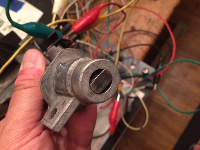

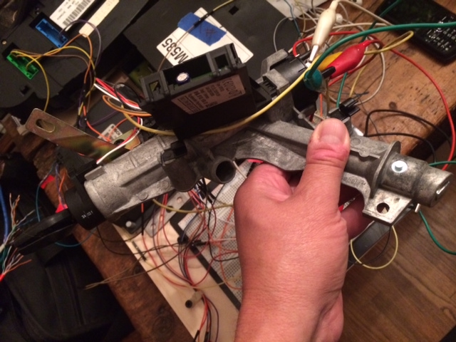

Hi GForce83,
Your issue is the lock assembly intermittently sticking internally. The system stays powered up until you pull the key out of the ignition. You can try to take it apart and spray some lucubration in the mechanical part that locks the wheel. However if it were mine I would just replace the lock assembly as the R&R time is not worth going back for seconds. Hope this helps.

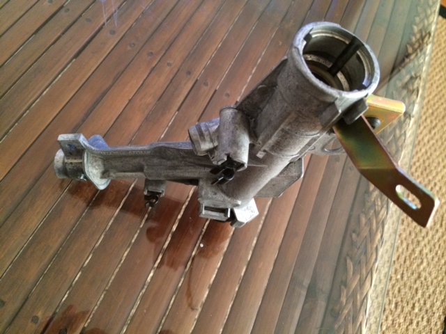

Hi GForce83,
If you have not replaced your lock assembly yet I have a nice used one for $100.00 + shipping.
