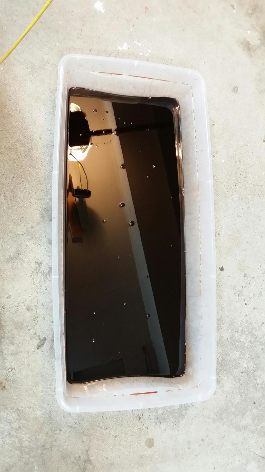

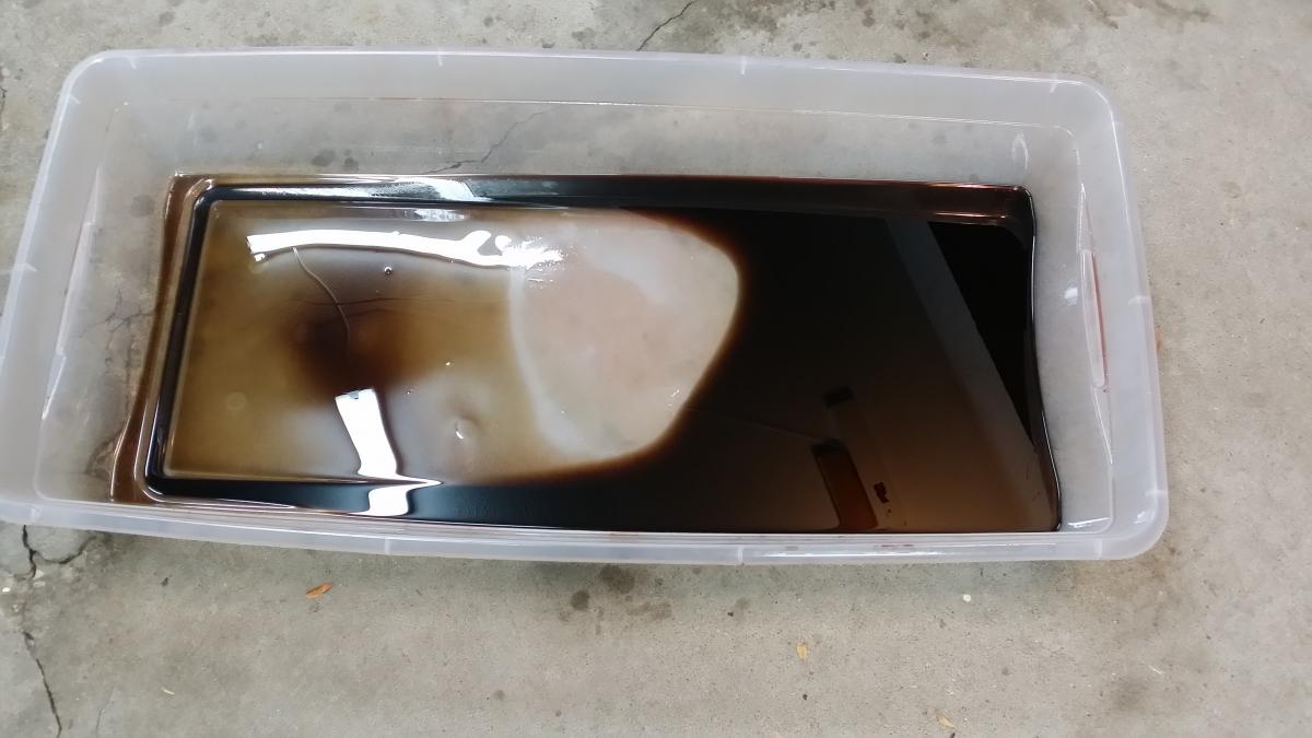

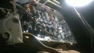

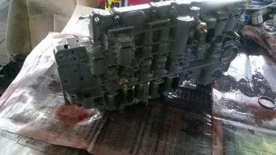

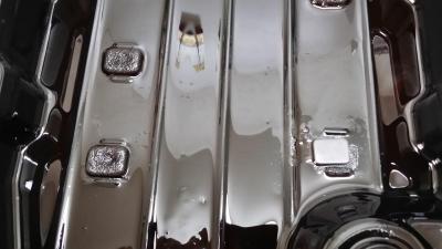

here is a few of the pics, dirty magnets in the oil pan, valve body out, valve body apart, and old vs cleaned solenoid and the black oil out of the transfer case and dirty oil out of the transmission.

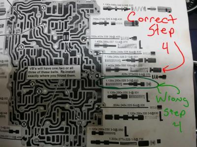

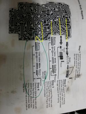

I would do the solenoids also. They are easy compared to taking out the valve body. You just spin a drill bit that they give you in the bushing to make sure the piston slides smoothly. You can't really mess it up. I also used red line d3 fluid. I'm not exactly sure how much it help the shifting, but it has great reviews everywhere. Also step 4 on the valve body valve swap is pointing to the wrong location. It's two valves up. I'll post a pic if I can remember. If I haven't by the time you do the install send me a message to remind me

Here are the corrected instructions. I'm unsure if all of the transgo instructions are wrong or that I just had a old kit. It's the same part just different views.
