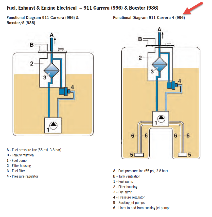

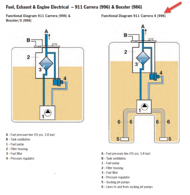

A C4 should hold about 64L of fuel total, it is possible that your gauge is not calibrated correctly as you should be down more that half a tank when the light comes on.
Here is the difference in your tank (C4, C4S, and Turbo)

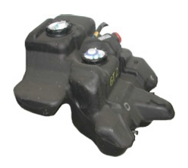

You tank actually looks like this (note the lower area where the level gauge does not go.

In the case of the 911 Carrera 4 (996), the shape and configuration of the fuel tank prevent the fuel
level sensing system from being able to physically read down to a level of 10 liters. Therefore, on the
911 Carrera 4 the driving-distance-on-remaining-fuel calculation begins when the fuel reaches a level of
19 liters (approx. 1/4 tank).

True friends. I have looked at pictures of the sender, it looks like it is pressed to the bottom by a spring, and there is a telescopic mecanism in the unit itself, There must be theoretical risk og the telescopic mecanism has got stucked in a high position and the foot of the unit is not at the bottom? Just a thought (and a easy check). But the above also makes sense.
