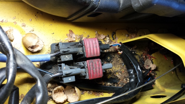

I finally was able to get the manual cable release and got it opened, only to find this...
Immediately didn't look right since my car is a garage queen with only 25k miles and is kept pretty clean.   Ugghhh!  At least I know what to fix now.
996 cable/wire sheathing seems to be tasty to critters. I had something eat through my knock sensor cable, but nothing a precision soldering iron can't fix.
If you don't have the pinout, let me know and I can snap some pics for you. The connectors are brittle so be careful when taking them apart. Probably obvious, but also make sure you plug in black to black plug and gray to gray plug when putting them back together.
Edited by xmac
Thanks xmac, but I was able to identify/match the wires successfully.  I got my replacement wiring harness for the main section that was ruined (the lower one in the pic).  Oh, and I saw a big 'ol rat running out a hole yesterday, so I now know what did the damage and have plugged the hole.
