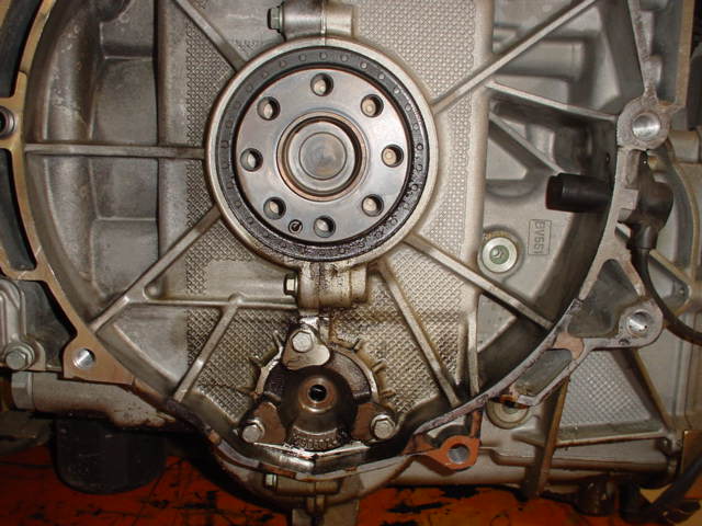

Yes. That's it at 3 O'clock.
BTW: The car is ready... I'll pick it up this afternoon, and will try to get pics of the broken flywheel.
This is a new one.  I'll have to ask Peter if he has ever seen the dual-mass flywheel come apart.  I have seen a lot of flywheels out of the car and none of them were damaged.
is that the pulse sender at three o'clock?

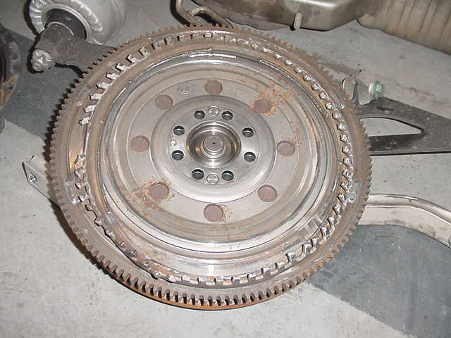

Here is a pic of the timing ring, laying on top of the flywheel. Normally it is welded to the flywheel. Overall, I'm pretty happy about the outcome - especially Porsche's committment to backing their cars and maintaining the perception of quality.
