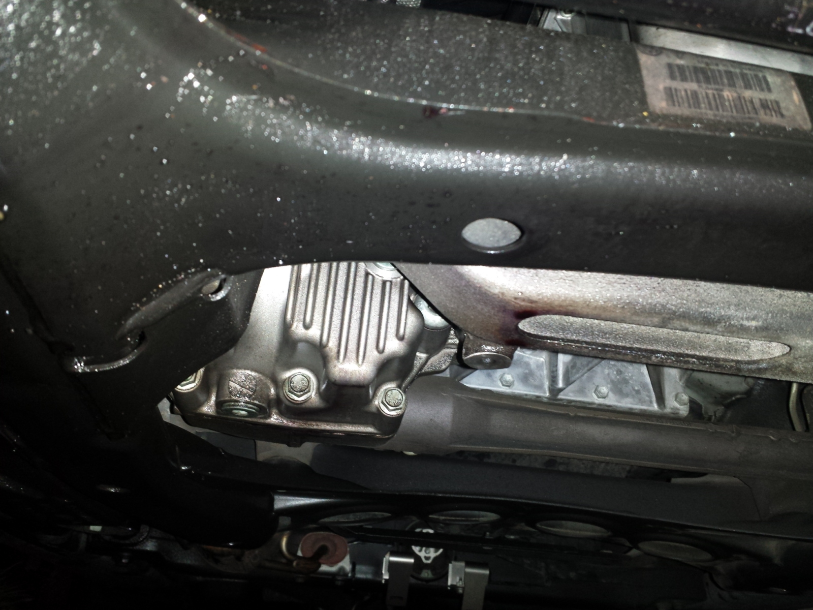

I just noticed my car leaking some liquid that doesn't look like its motor oil as it not coming from the filter or oil pan. It's more to the the passenger side and from the front differential i think but i might be wrong. I took a couple pictures one from the pan that is full of purple oil and from a small hose that looks like it might be leaking from there but I'm not 100% sure. Has anyone experienced this or could point me to what is causing this and a fix.

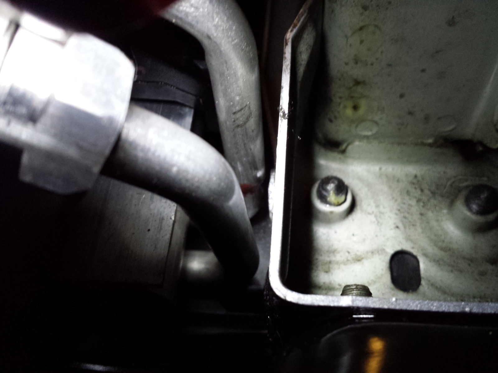

Would this be the line that that goes back and forth? It's the line I found that has the most fluid all over it. Either way I will be checking to see if its oil or coolant when I get home. If its not the line can any give me a pic of where the line would be located on a 06 cayenne v6.

Forgot to mention, that same line in this pic seems a little loose. I can wiggle it and im not too sure if that means its broken or not fitted correctly.

That line is the vent for the front differential, the purple fluid on the subframe on your last pic in the first post is probably from the hydraulic engine mounts. You need to determine what fluid type you actually have sprayed all over the area.

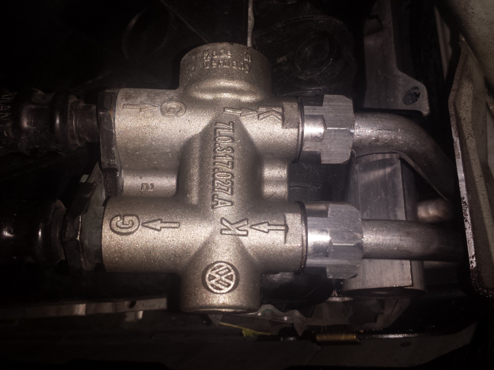

Ok I found where it is coming from and it looks like it is a coolant leak. I don't know what this part is exactly but if someone could shed some light and a part number that would be great (I assume the number on the part 7LO.317.027.A) but could not find it through google. Also, is there something i can put temporarily like "for a lack of a better work" duck tape.

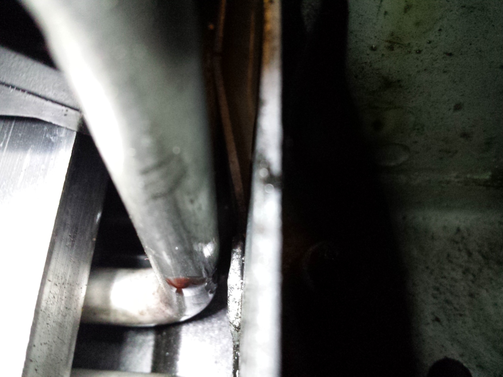

So, the cause is there was no bolt holding this piece to what seems to be the radiator as support. Since it was loose it was rubbing and banging on a metal frame and must have punctured the top line. The line punctured is the ->K (out) line. Now that i put a bolt to hold the piece it seems it is now leaking more than before as it doesn't have the frame to maybe close it. Either way, i'd like to replace this whole line and if someone has some tips or DIY it would be great. Thanks again to those who have replied to my post :-).

Looks like a oil Thermostat for the ATF Cooler. Must be a thermostat for one of the heat exchangers. A V6 only part I think. Not 100% sure from the pic but you mean it is the Aluminum pipe that was rubbing & Leaking, not the rubber hose?

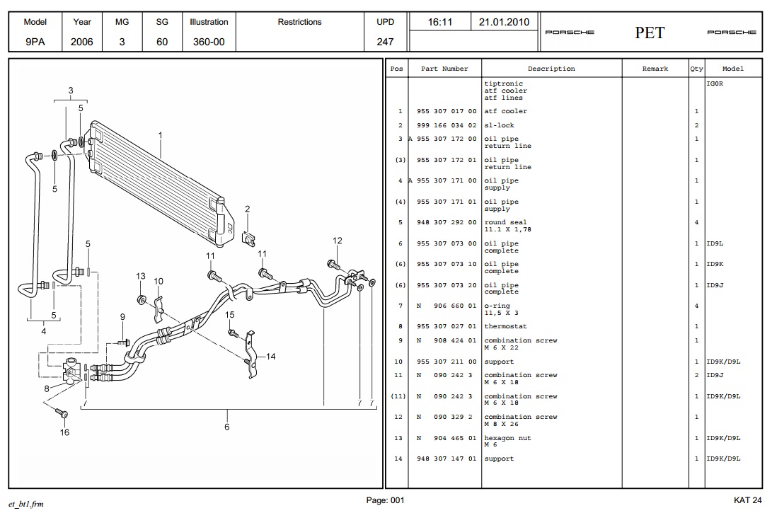

Got to this Porsche page and download the parts .pdf for the Cayenne. Make sure you do the 2003-2006 year. Then open it and go to page 145 and there are the parts you need. A real handy parts .pdf from Porsche. You can go to www.sonnen.com and plug in the part numbers for good prices, less than most other dealers and the website will also give you the new part number if the part has been superseded with a new part. Usually only the last two digits change when Porsche changes or updates a part. If it doesn't work PM me and I can send you the .pdf, it is about 20.5MB

On the last pic you can see where that round metal piece on the frame was rubbing against the aluminum pipe and punctured it. I wiped it clean and after 5 to 10 min a few drops were noticeable (Purple/Redish liquid).
Is this the PDF your talking about? If so, I went to page 145 and has a diagram of a wiring harness. If its not, I can PM you so I can grab the correct one. Thanks!
http://www.porsche.com/all/media/pdf/originalparts/en/E_9PA_KATALOG.pdf
That's the page. Those are lines for the ATF cooler so you may need to get the level in your transmission checked depending on how much it leaked.  Sorry about that, I was typing faster than I was thinking. Some spelling mistakes and no link I see :)
