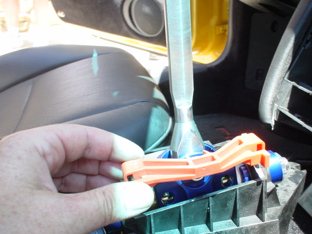

The tool only works with the oem shift. It will not fit on the B&M/Porsche 996 short shift.
When Porsche started selling the B&M clone I had hoped Porsche would come out with a new version of the tool that would work with B&M/Porsche. No such tool is in the 2004 tool catalog and at our tech session last week Peter checked the new tool bulletins and there was nothing.
This is me trying to put it on a B&M. Not even close.
