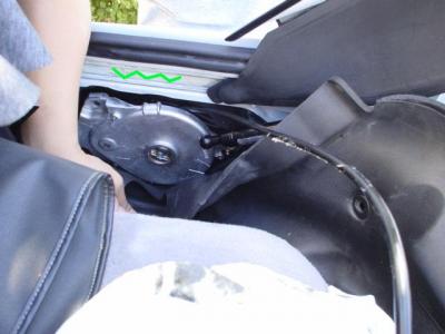

When my top is up, the top "mechanicals" squeak a lot. It seems to mostly come from the joints in the bend of the top, where the top slopes from where the rear window is to horizontal. There seems to be a gear-type thing in the bend that seems to cause the most noise.
Has anyone ever lubricated these parts? Are there any other parts of the top that need to be lubricated?
While we're on the subject, where are the top drains and what is the best way to clean them?
