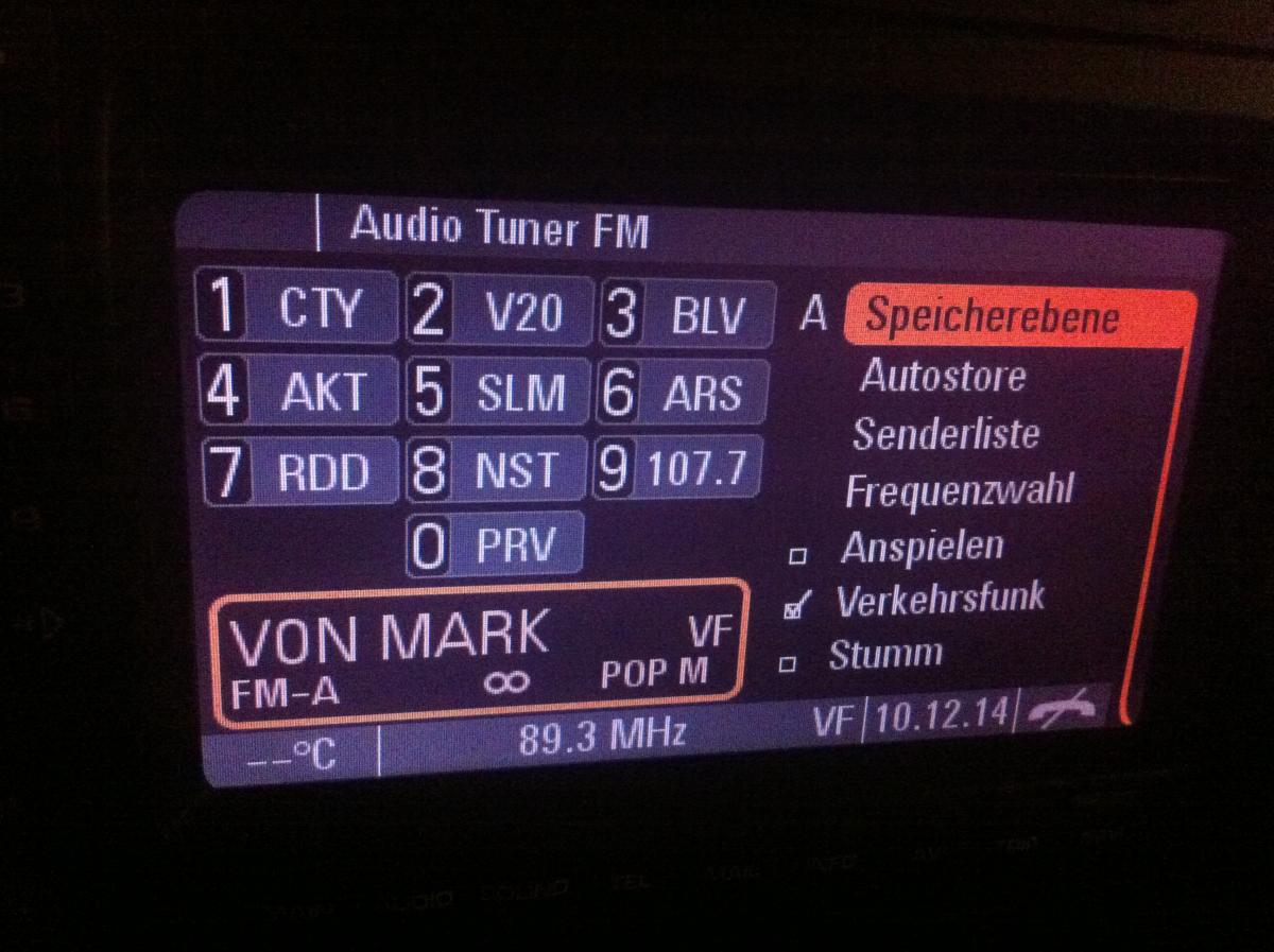

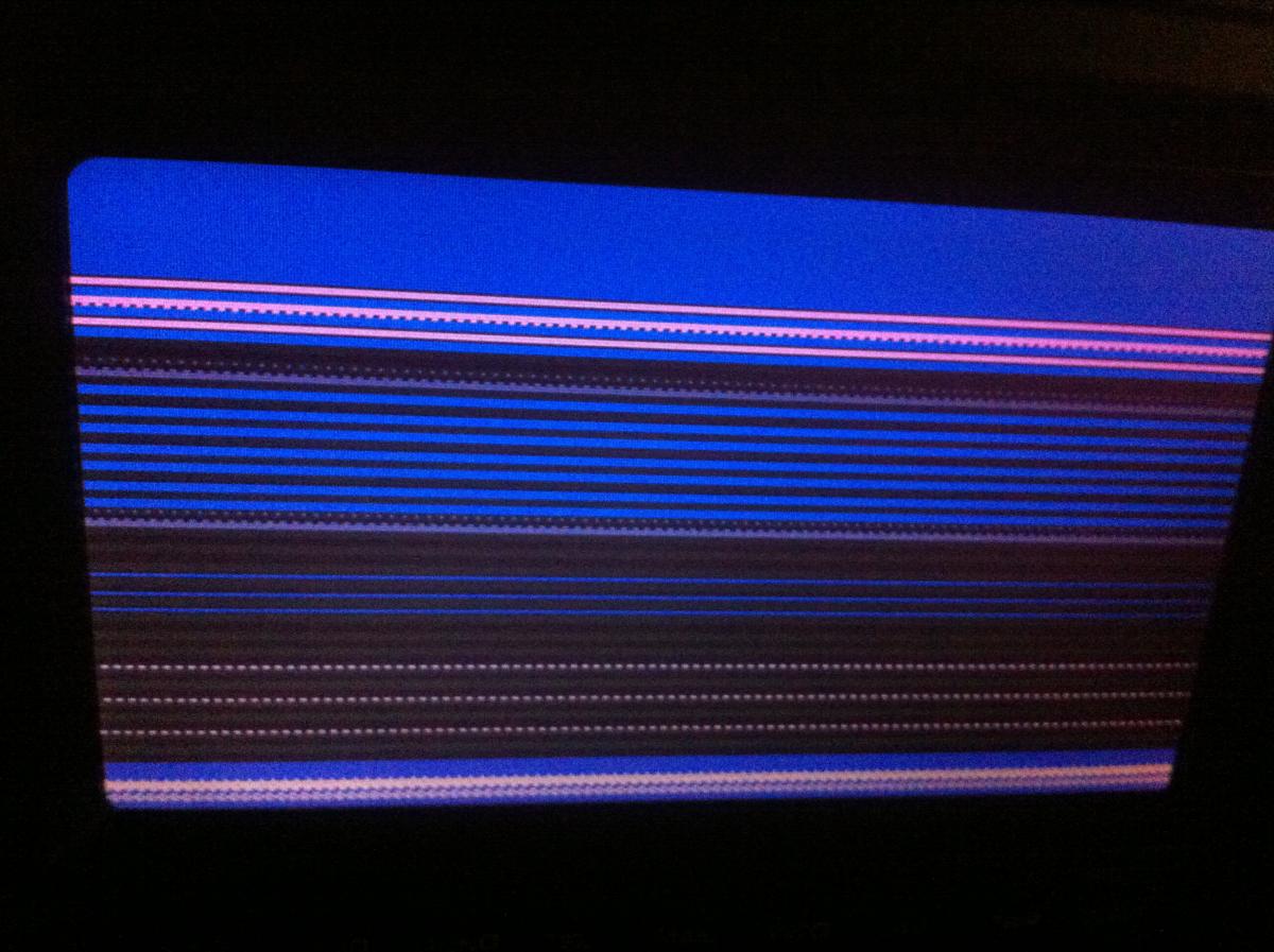

Already from the day i bought this used machine i had Problems with the PCM. Audio works perfect but the Display was showing nothing else than strange colours and signs. I was planning to send the unit to a Special repair shop soon.
But SURPRISE today when i started the car and switched on Radio the Display was ok. I switched from Music Channel to Channel to navi and so on. Always a display how it should be. First time since i own this car. But when i pushed the cd Button again :-(
Strange display like Before . Maybe somebody can give me a hint whats going on here?! Thank you
My 06 S just started having issues last week.  Boots with the logo then turns into all lines all button functions work.  Mine will also shut down randomly after 15 to 30 minutes.  Saw the screen replacement process looks pretty straight forward although with it randomly shutting down worth the cash for the screen?

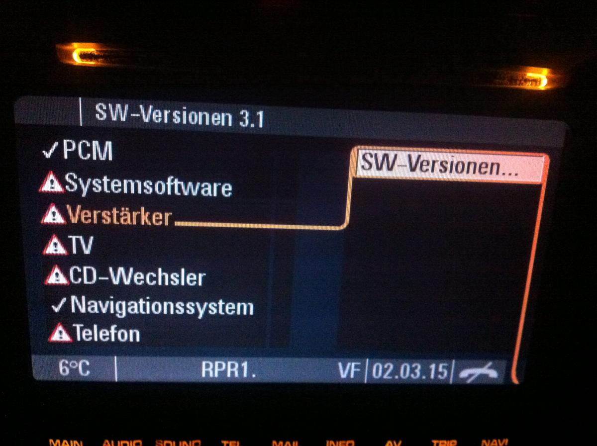

I would like to ask again your opinion . I almost bought a new display for some hundreds and decide to take out the Unit before to order . I disconnect and reconnect the old display. What i found out or lets say what i believe the problem is not the display itself. When i install the Unit back in place and switched on it was working. Depending on how much i push the Unit on the left side. I guess the problem is somewhere else. Could it be possible that this a ground problem or something else. The Unit is reacting on some kind of Force. Now it is inside the place where it should be but i didnt let it slide in completely . Any advise is welcome.
Sounds very much like an poor connection to the screen internally by the last screen shot seems to imply communication problems on the MOST bus since there are exclamation marks everywhere. Perhaps two different problems.
