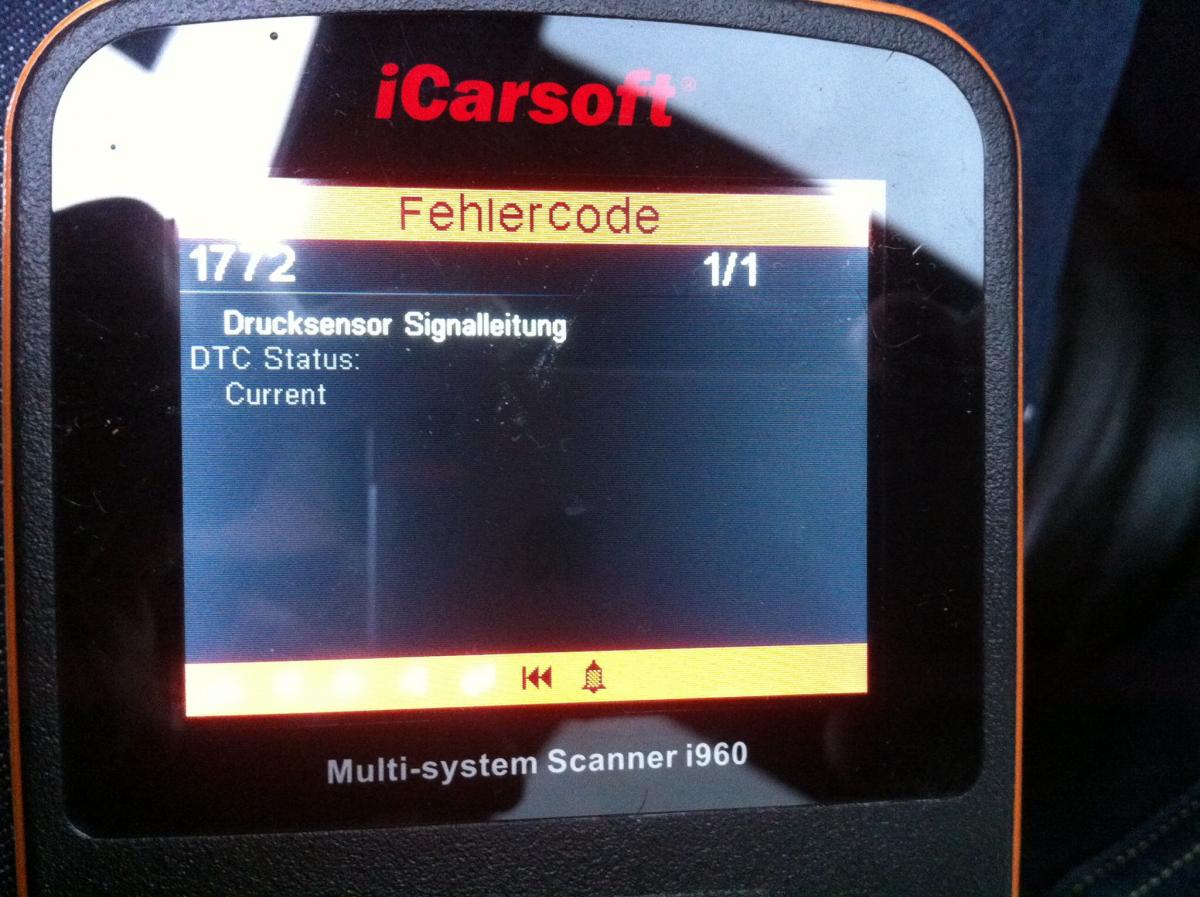

loud noise driver side under wheelhousing
onother problem, i hope not that big.
i hear this noise already one week before. but all week i could drive and didnt notice anything.
today it came back. it is even there when the engine is not running but key is in the lock.
it stay there for some minutes. terrible loud. than its going away. what i found out its coming from inside the wheel housing.
maybe airmatic?

There is an auxiliary circulation pump inside the left front wing, firewall side, which pumps the residual heat from the engine cooling system through the cabin heather core over a given time, only with key inserted in the ignition switch. The aim is to enjoy the passenger(s) with a few minutes of heat while the driver is outside the car, and the engine is disabled. That thing can cause quite a lot of noise, I would check that one day.
