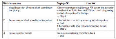

Fault code P0721 - Output shaft speed inductive pickup [Output Speed Sensor Circuit Range/Performance]
Possible causes of fault
- 'Implausible signal', mechanical damage in sensor wheel or inductive pickup
- 'Implausible signal', inductive pickup faulty
- 'Implausible signal', Tiptronic control module faulty
(click to enlarge)

in the table step 3 said replacing the control modules, will the tech know what it is if I print out this page and gives to him?
