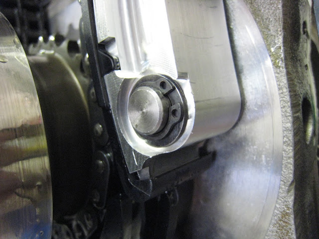

Trying to find the part # for the washer that goes behind the cclip on the LNE IMS tensioner paddle.
Heres a picture form another build thread:

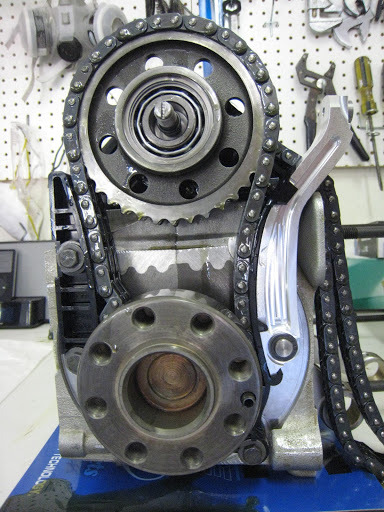

Also need the part#'s for the bolts to attach the plastic guide...left plastic in this pic:
Also note that pelican lists a timing chain part # 996-105-171-55-INT as fitting the 3.6 C4S. It doesn't. I need to get part # 996-105-171-58-M100 at 4 times the price. yay. Another delay...was hoping I could get drop the bearing case in last night and do cyl 1,2 ,3....but I'll have to wait.
