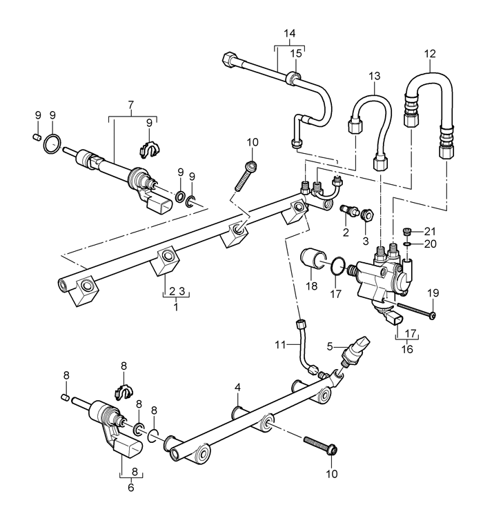

Is anyone familiar with the valve (item 2/3).     I actually changed the high pressure fuel pump a few days ago hoping that was the cold start problem.  While changing the pump I  didnt see what totally appears to be a pressure valve.  item 2/3 looks like it.   the right two connectors are low pressure but I am thinking that valve might be at high pressure..
