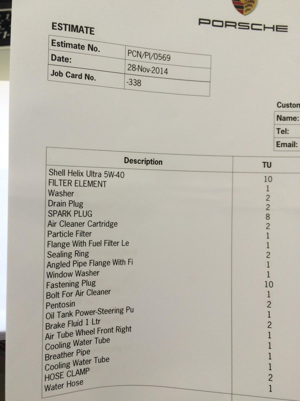

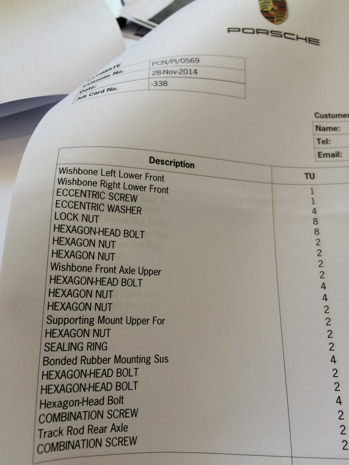

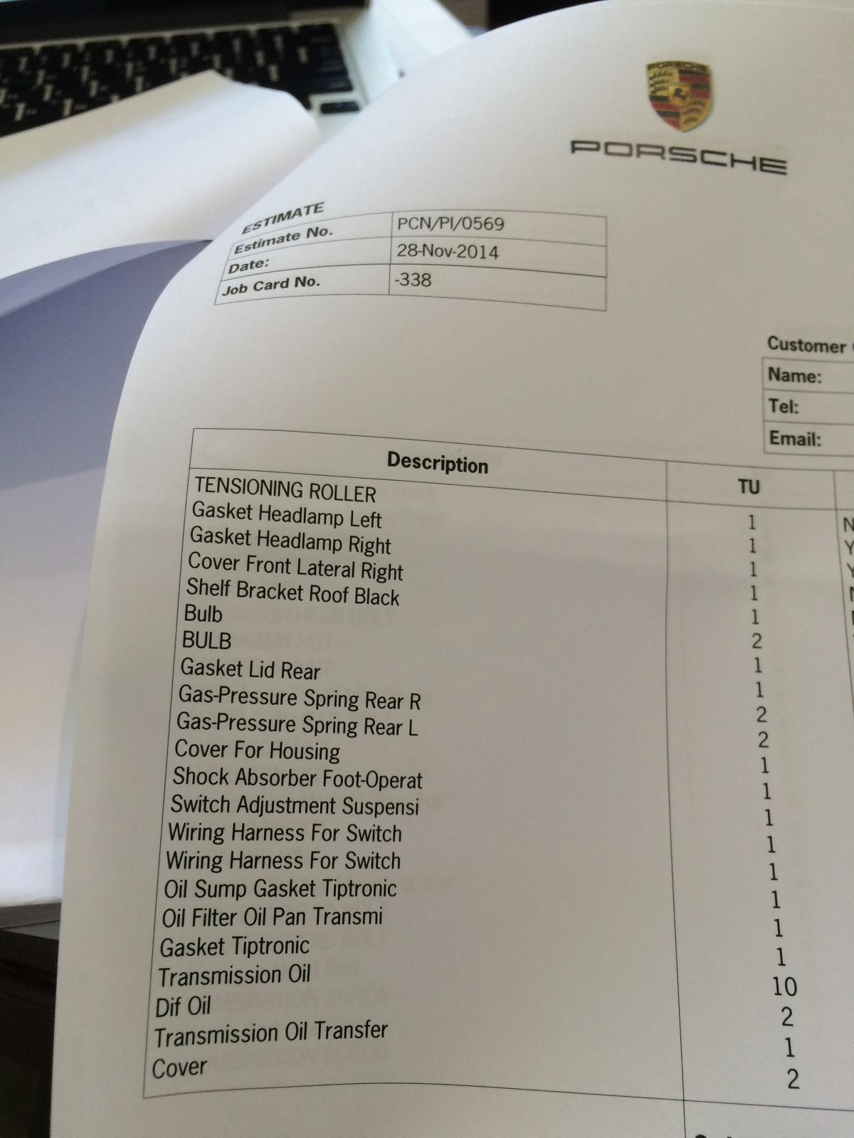

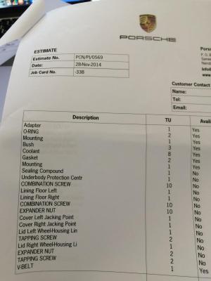

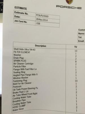

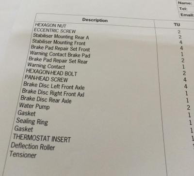

To add to this nightmare, they gave me 5 pages of spare parts for the car.post-99047-0-81772200-1423131540_thumb.jpost-99047-0-01956800-1423131570_thumb.jpost-99047-0-43707200-1423131597_thumb.jpost-99047-0-80064500-1423131625_thumb.jpost-99047-0-05986600-1423131841_thumb.j
I have no idea where to start... Any insight as to what I should change asap, and what can wait till later...
Please help...!!
